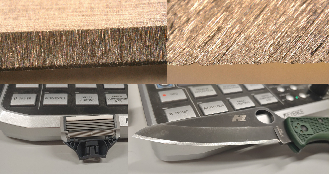

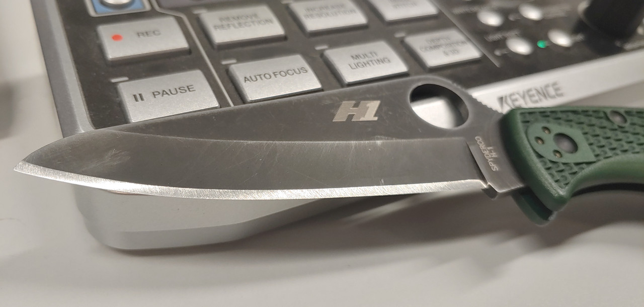

Session #2

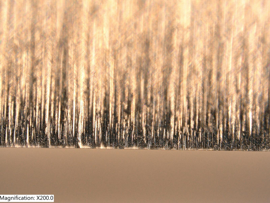

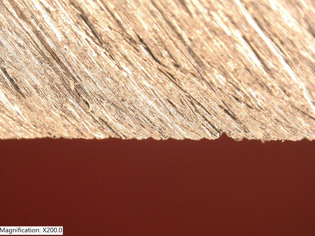

First I have a fresh razor from Harry's.
Brand new and able to cleanly shave as expected.

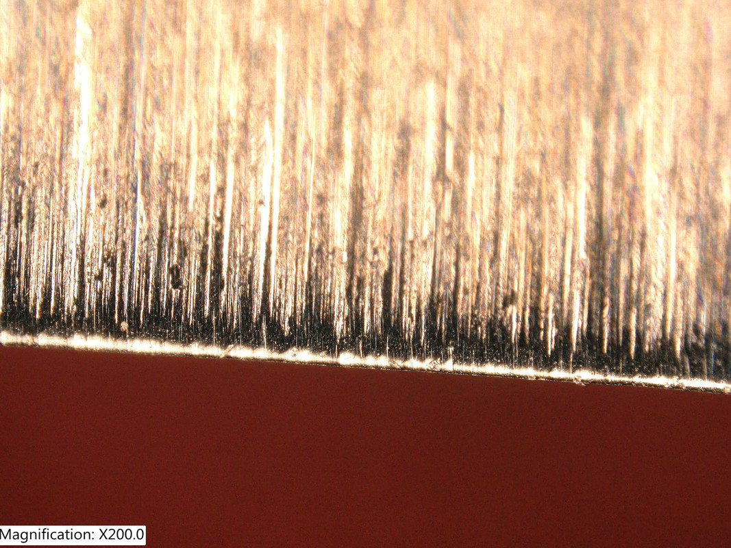

Very clean, refined apex. The only imperfections appeared to be lint or oil. This is exactly the type of edge you'd expect to see on a razor blade, no surprises.
Now, on to the Pacific Salts.

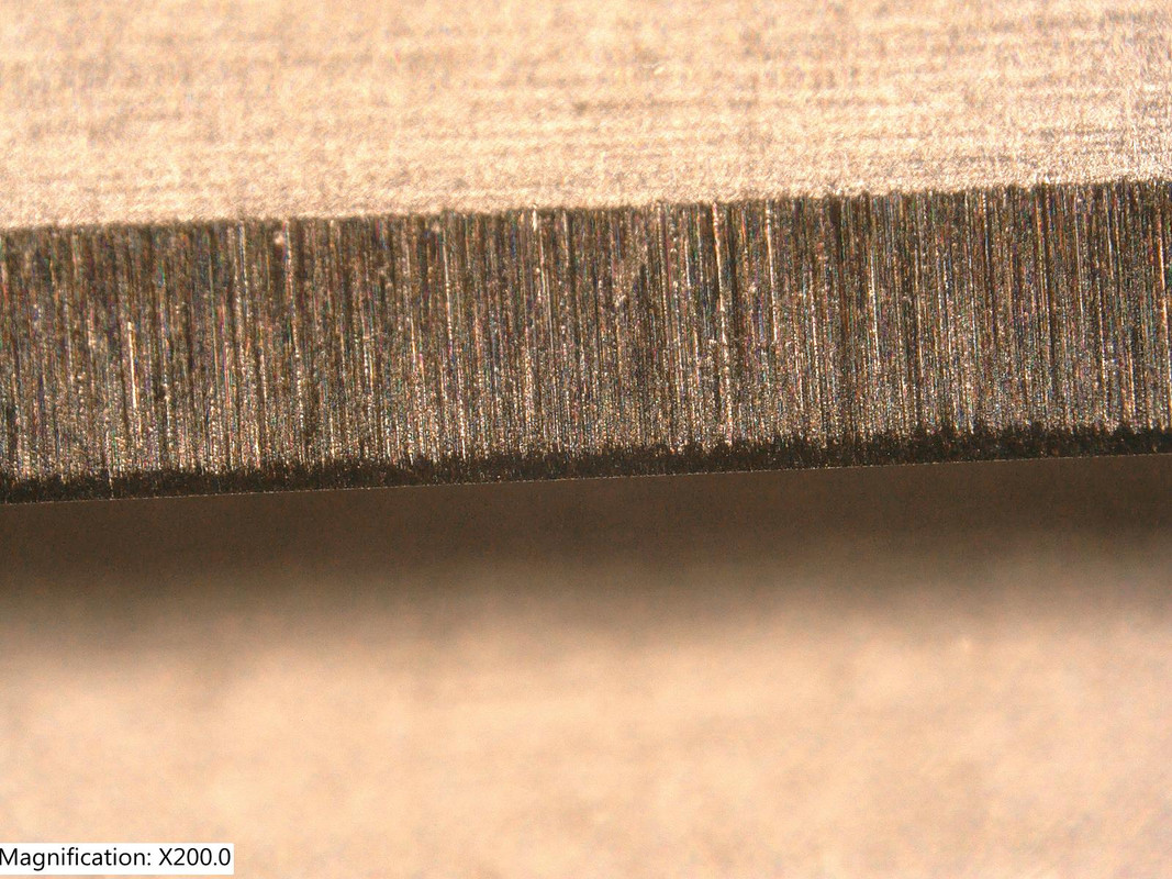

First we have my daily user Pacific Salt 2 sharpened to around 10-12 degrees per side. I sharpened it right before looking at the edges, using a 200 grit diamond stone, the coarsest side of the 4 sided harbor freight stone.
Despite the coarse finish, the 200 grit edge can easily shave. Obviously the smoothness of the shave cannot compare to the razor, but it demonstrates the apex can be refined to shaving sharpness even at 200 grit.

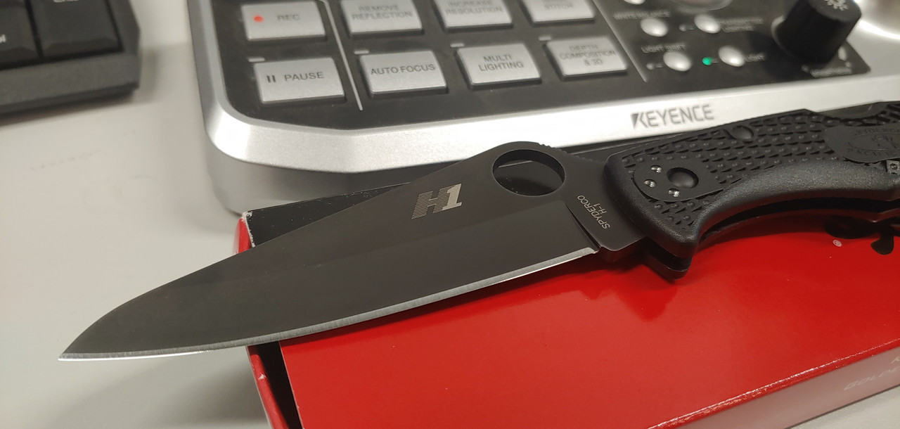

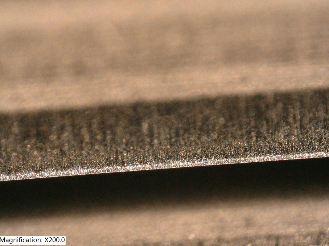

This is a brand new Pacific Salt 2. As you'll see, the factory edge appears to be applied with a medium grit belt, then the apex is finished with a buffing machine. This knife also readily shaves, which is expected from a Spyderco factory edge.

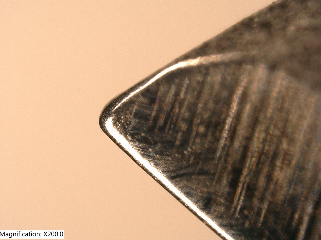

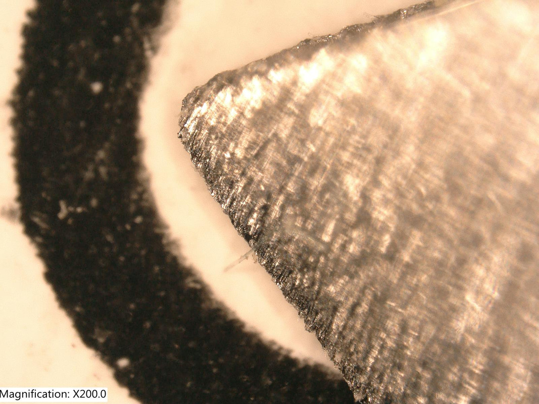

First I want to compare something that surprised me. The tips.
Pacific User:
Pacific NIB:
As you can see the NIB one looks completely rounded off, while my user doesn't look much better. Both are perfectly functional feeling tips in use, easily penetrating plastic wrap etc.

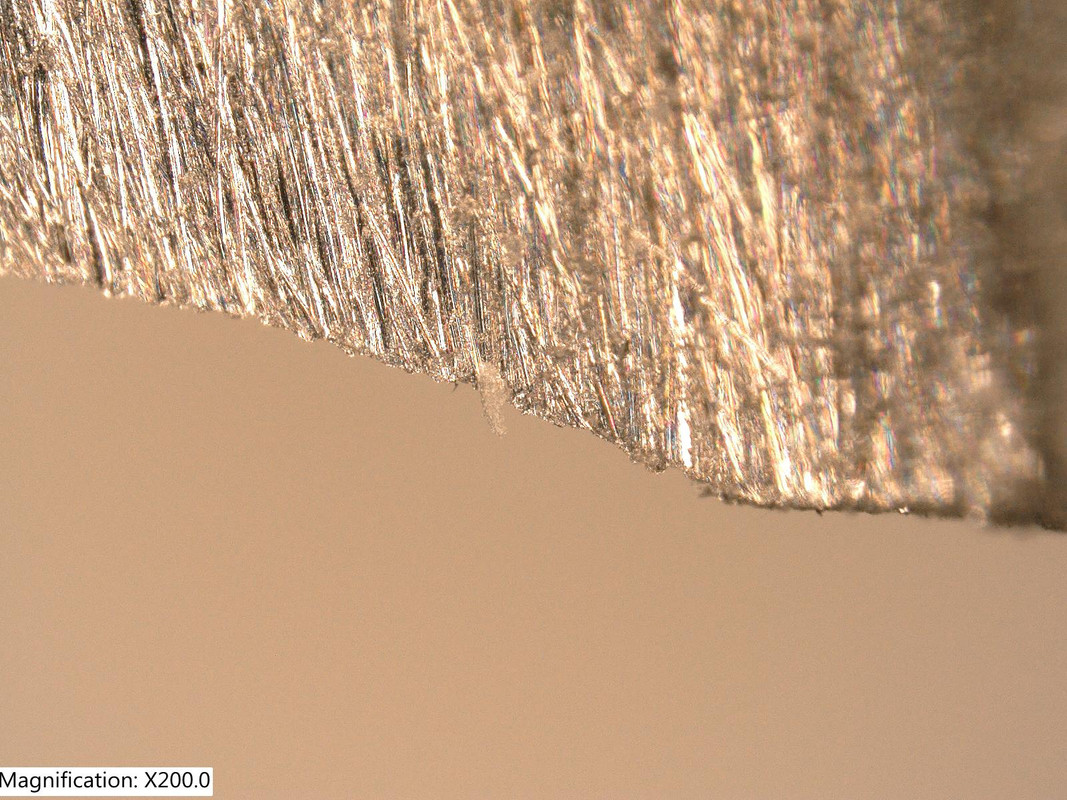

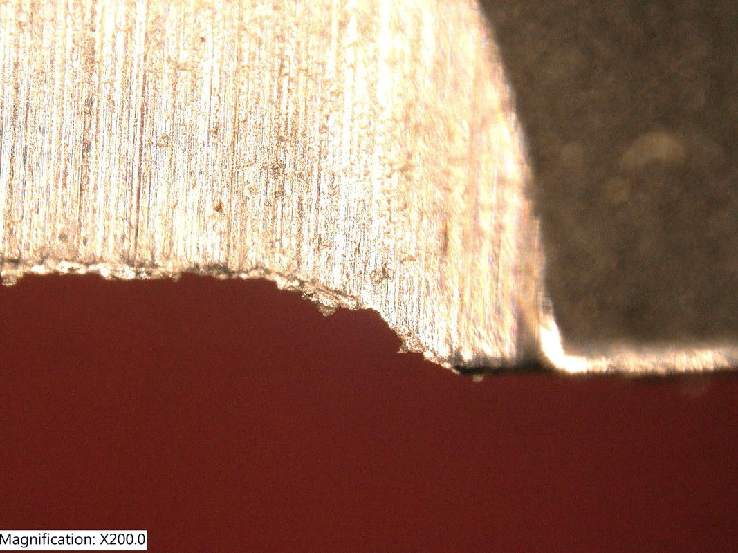

Now let's look at the ricasso area, something I've never paid much attention to when observing knives under magnification:
Pacific User:
Pacific NIB:
I found this comparison interesting because the NIB edge looks kind of ragged like my 200 grit edge.

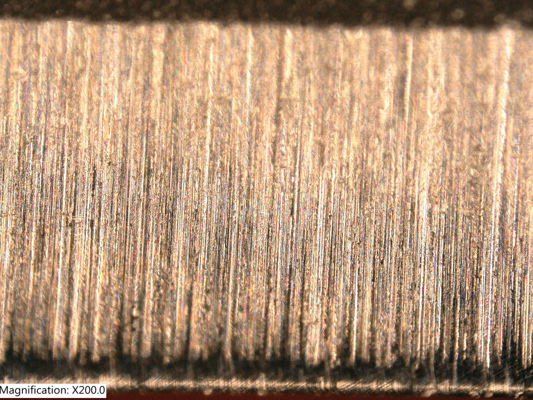

Before we compare the apex side by side, let's take a look at the scratch pattern on the bevel.
Pacific User:
Pacific NIB:
You can see the used one has much deeper scratches. They're also at a different angle.
I don't think the angle of the scratch pattern matters much on a polished edge. With coarse edges, however, it influences how efficiently the blade cuts using a pushing or pulling motion while slicing.

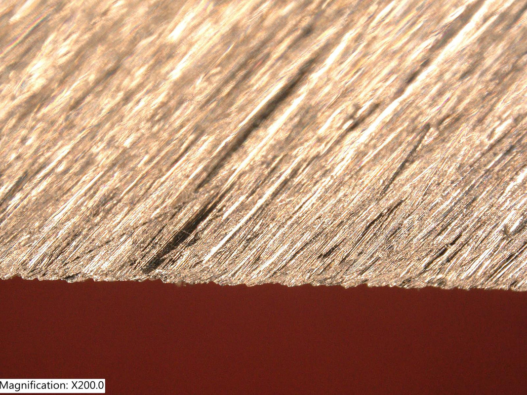

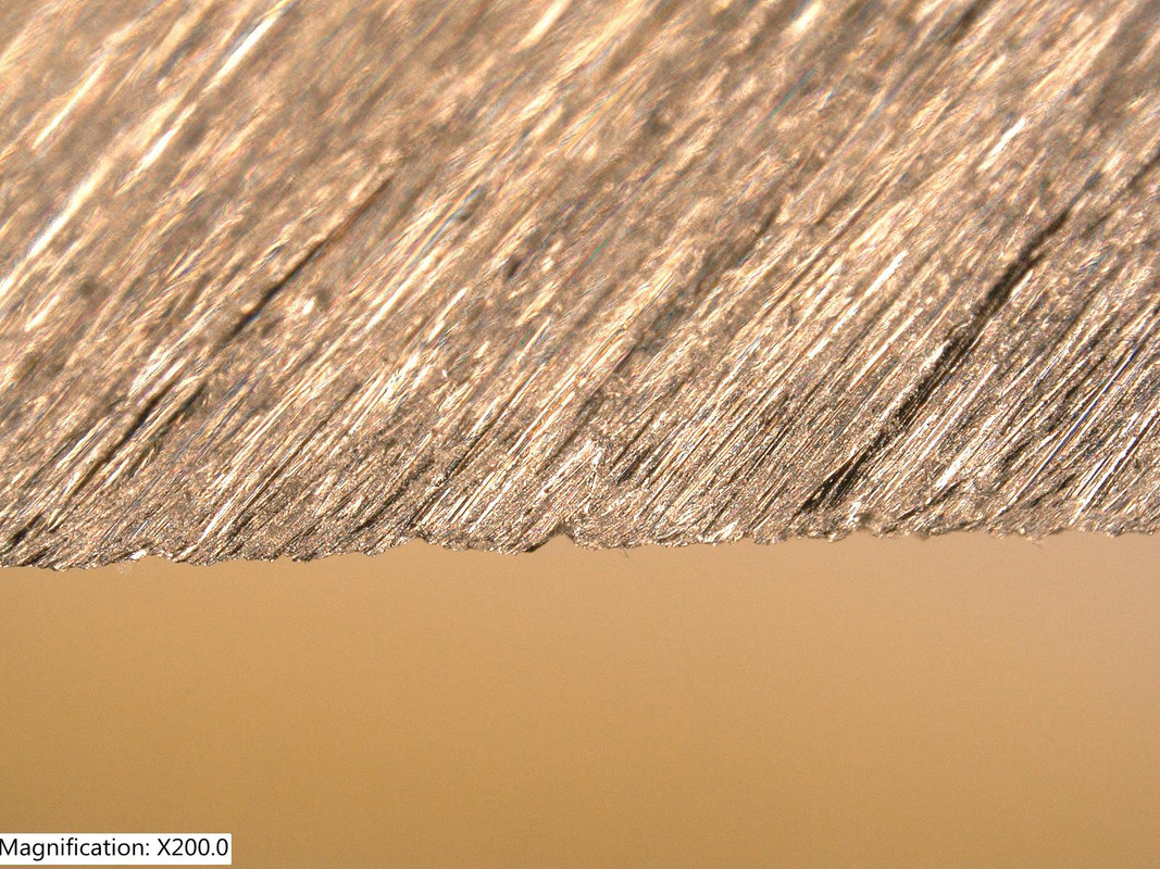

Now let's compare their apexes side by side.
Here's four of the NIB Pacific, two from the show side, then two from the back side.
Pacific NIB:

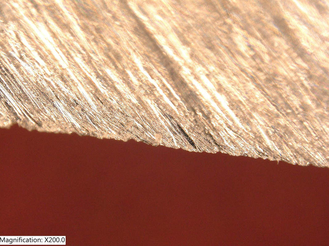

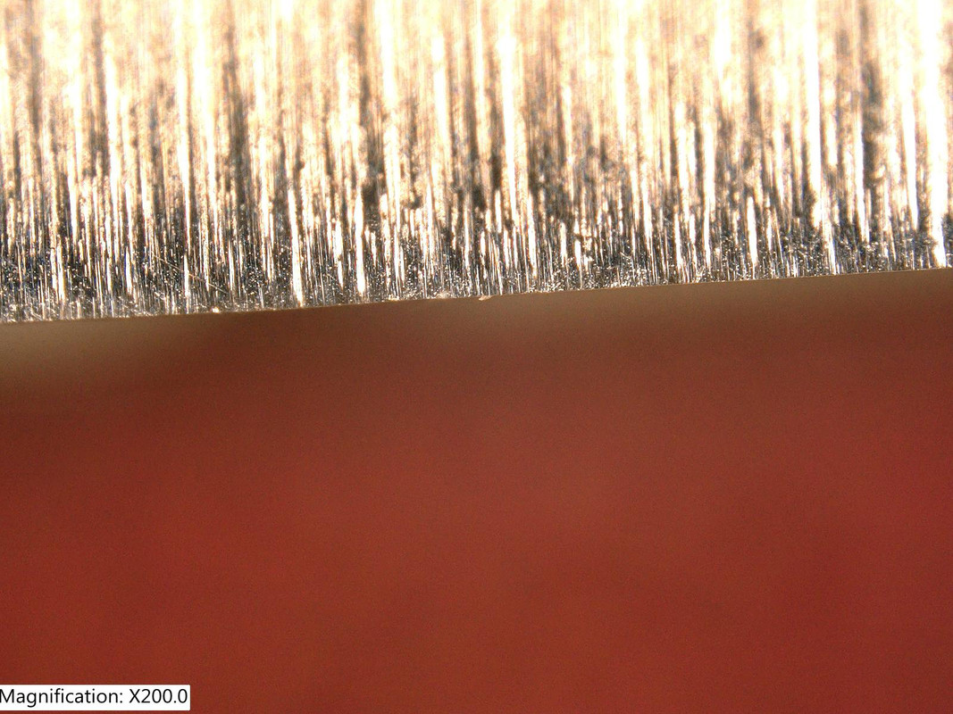

Now the 200 grit edged user.
Pacific User:

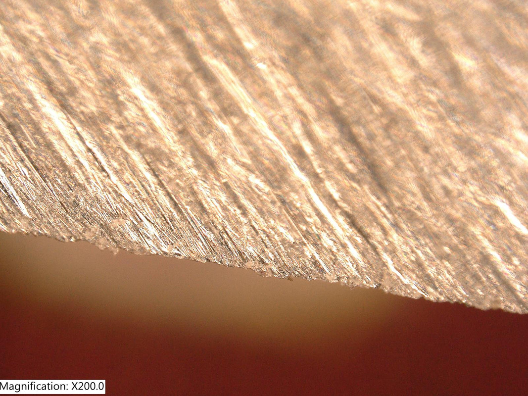

These first two images show what first appeared to be small chips to me. Presentation side is first, then the back side. This must be from some of the larger diamond grits on my sharpening stone, because this is a fresh, unused edge.
Here are some more images of the user, presentation side first, then back side.

That NIB edge near the ricasso doesn't look like a rough edge, it looks like a burr. I'm guessing the finishing process wasn't able to hit that spot to clean it up.

Taking a closer look I think you're right. Looks like the remains of a burr.metaphoricalsimile wrote: ↑Thu Jun 23, 2022 4:13 pmThat NIB edge near the ricasso doesn't look like a rough edge, it looks like a burr. I'm guessing the finishing process wasn't able to hit that spot to clean it up.

With both edges fresh the NIB would be superior for push cutting and the user better on a slice. The user would have a geometry advantage that would reduce pressure needed to cut stiffer materials and help extend edge life.
Which edge would be best depends on the application.
Re: Looking at "Vivi edges" with a VHX-6000 digital microscope
Thanks for posting Vivi! Very interesting. The low grit does look like small serrations and directly correlate to the use you have experienced.
