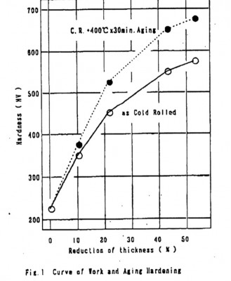

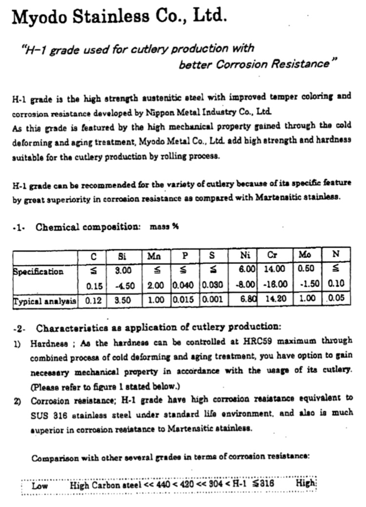

I was just sent the Myodo datasheet for H1 which has a couple interesting things in it. For one H1 was developed by Nippon. Typically a datasheet for a steel doesn’t call out the original developer of a grade so this is somewhat unusual. Presumably this means there is a Nippon patent for H1 which might have something interesting in it if we can find it.
Another interesting thing is that a “typical analysis” is given which shows that Myodo had a target Cr of 14.2% even though that is quite low for the specification of 14-16%. That helps explain why Sandvik found only 13.8% Cr in their measurement of H1’s composition. They could have a few different reasons for targeting a lower Cr such as helping reduce delta ferrite or affecting its transformation during cold rolling.
The datasheet also confirms that the values for C, N, Mn, P, and S are maximums as I stated in my articles about H1 and H2.
Myodo also states that H1 is prone to overtempering during grinding, which perhaps explains Sandvik’s reduced hardness value of H1 near the edge. Such effects are why it is difficult to believe that there is actually a hardness increase from grinding operations.
