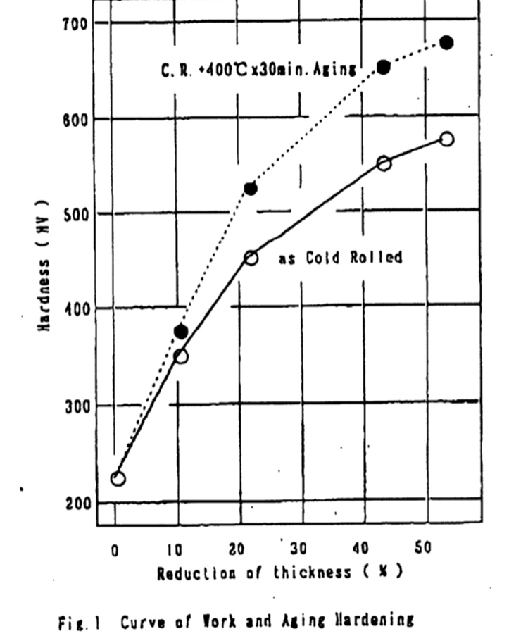

The purpose of the cold working process is to use physical strain to transform the steel from the non-magnetic soft austenite into the hard martensite phase, which *is* magnetic, so that's evidence that the cold-rolling process did its job.

According to Dr. Larrin’s article on H1, he states that Sandvik could not duplicate the results that Crucible achieved. Quoted below.
“I was sent an analysis of H1 in a Spyderco Salt by Sandvik. They did not find an increase in hardness at the edge, in fact they found a decrease. The plot below is what I was sent, where the value at about 55 Rc was 0.4 mm (0.16″) from the edge. Unfortunately I was not provided an x-asis to see the distances between the measurements. However, the ~57 Rc of the steel is comparable to the value reported above from Crucible. It may be that the hardness was reduced at the edge due to overtempering as a result of grinding.”

I was just sent the Myodo datasheet for H1 which has a couple interesting things in it. For one H1 was developed by Nippon. Typically a datasheet for a steel doesn’t call out the original developer of a grade so this is somewhat unusual. Presumably this means there is a Nippon patent for H1 which might have something interesting in it if we can find it.
Another interesting thing is that a “typical analysis” is given which shows that Myodo had a target Cr of 14.2% even though that is quite low for the specification of 14-16%. That helps explain why Sandvik found only 13.8% Cr in their measurement of H1’s composition. They could have a few different reasons for targeting a lower Cr such as helping reduce delta ferrite or affecting its transformation during cold rolling.
The datasheet also confirms that the values for C, N, Mn, P, and S are maximums as I stated in my articles about H1 and H2.
Myodo also states that H1 is prone to overtempering during grinding, which perhaps explains Sandvik’s reduced hardness value of H1 near the edge. Such effects are why it is difficult to believe that there is actually a hardness increase from grinding operations.
