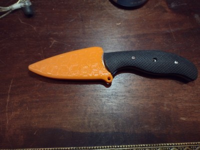

Sheath printed in PETG at 80% infill. Works great! Main usage will be for keeping the knives sheathed when stored away. Would probably be fine in the pocket as well.
I prefer this friction sheath over the other one that uses a clip to retain the knife because I usually trim down the guard on the mules that I keep.
Thanks Josh!

rooster81 wrote:
Mon Feb 27, 2023 5:31 pm
Thanks Josh!
Very cool! Love the orange.
It still needs a few updates when I have the time. The way it is the plastic will wear out making it loose over time. So I plan on adding a hole next to the thumb ramp to slide a small piece of o-ring/rubber rod. The rubber would be the main source of retention and shouldn't wear out. Originally it was going to be put in the existing hole but the nub would need modified for that to work.
