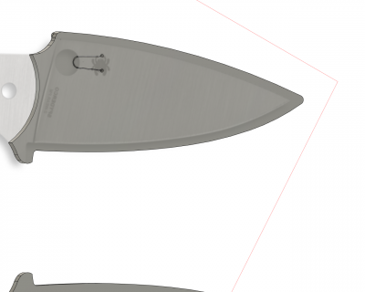

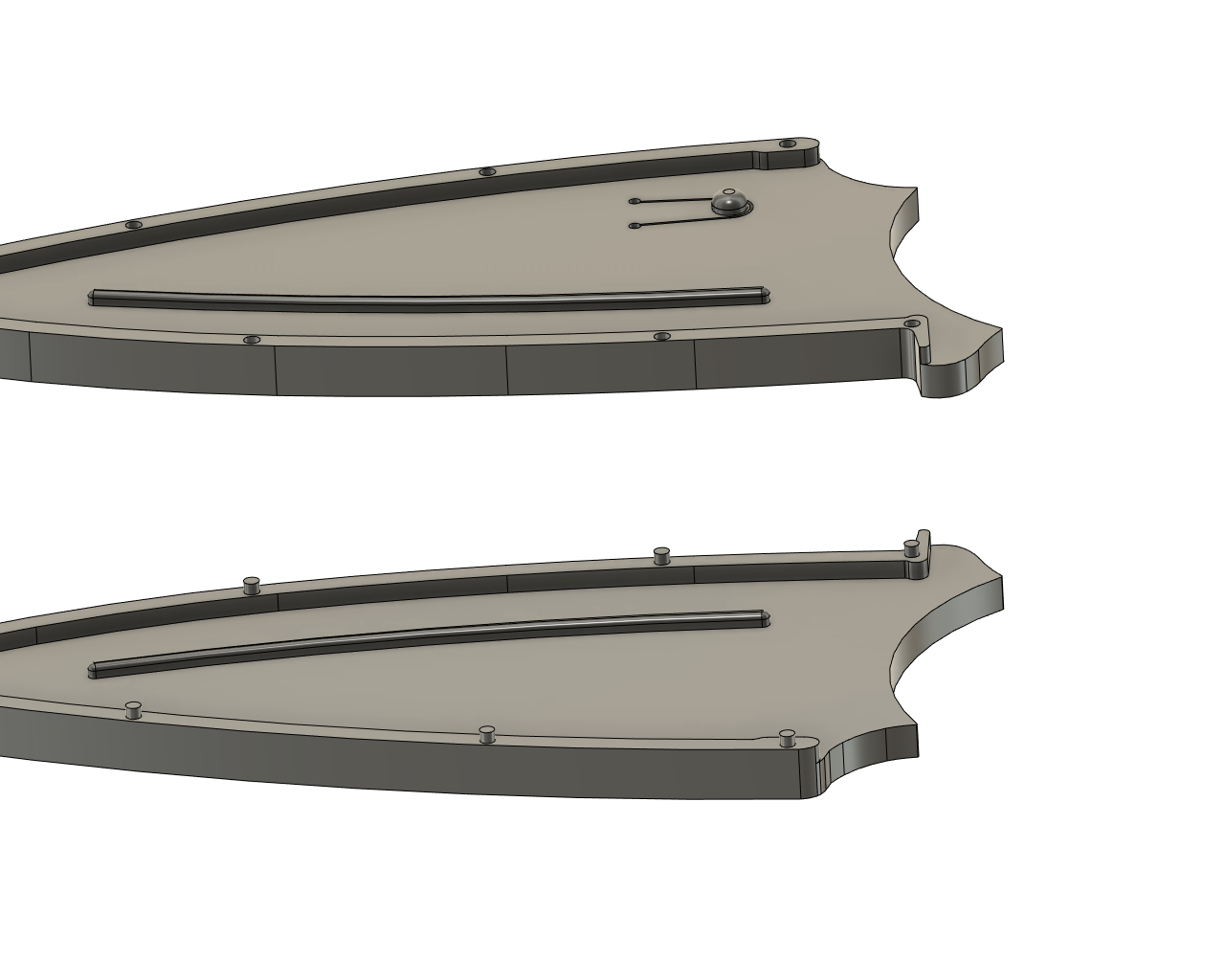

This is the first version of my 3d printed sheath that's going to be matched up to my scale designs. It is a 2 piece clam-shell that uses the Spydiehole for retention. The belt clip still needs designed, not sure how it's gonna look yet. Once I test and make any changes needed I'll post the files.

Looking very nice already, and using the Spyderhole for retention is ingenious !
I wouldn't have thought about this simple yet elegant solution :cheap-sunglasses
Also, if possible, releasing a version without the belt clip (basically the version you've just posted) would be appreciated.
It's perfect for those using the sheath for storage purposes.

have you thought of making a button to push to release the hole divot or do you prefer the tension method? Looks great.

That's a good idea I might try that if it's too hard to remove. Could just open the Spydiehole on the opposite side,, even if it doesn't help it might look better.

The sea-saw button method was what I was thinking. Two opposing diving boards if you will with a fulcrum if the plastic can do that.

This is what I came up with the other day but don't like the look so I'm still looking at options.

I don't think the resin is strong enough for the release and it probably wont need it. I really like the idea of a button similar to pistol holster though. That way it can be made from a stronger material but it would need a pin and spring.
