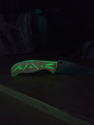

Post by ykspydiefan »
Still needs some sanding and clear coat.
Posts: 5691
Joined: Sat Mar 03, 2007 1:27 pm
Location: CalyFRNia
Re: Show your Mule
#1362
Ha! That's awesome. Love the glow pattern! Might have to copy your idea sometime...!
