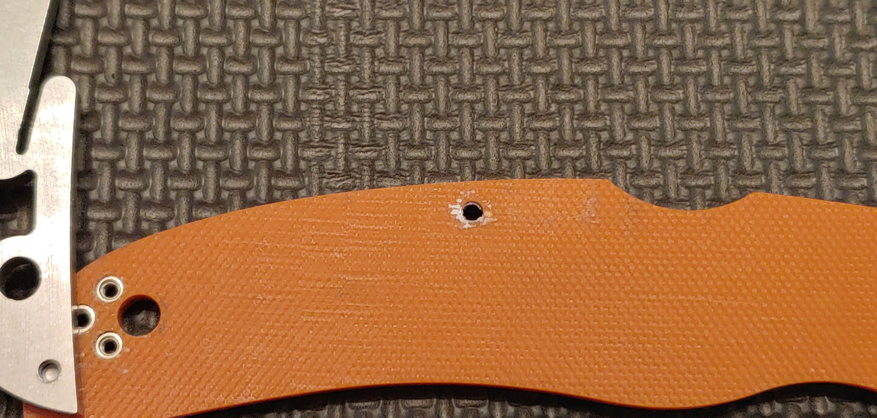

I'm having an issue with US made Spydies
Re: I'm having an issue with US made Spydies
First issue I see is using boiling water. I know you are trying to melt the loctite a bit but you are actually expanding both the screw and what it is screwed into. You want to heat just the tube to expand it and not the screw. Another thing that helps is putting your torx bit in the screw, twist counter-clockwise a bit as you whack the top with a hammer. The impact helps break loose stubborn screws. It is the same idea as a hand held spring assisted impact driver. Now, if only I could find smaller impact rated torx bits for mine(my kit at work only goes down to t30). Good luck! -Chad

My Caribbeans were absolutely caked with white colored thread locker. One of the pivot screws is permanently attached to the pivot. I consider myself to be well above average in being able to get knives apart without stripping screws and overcoming thread locker (just based on all the threads seeing how often people struggle with it while I rarely do) so when I encounter one that's hard to get apart it had to be really bad.

I've disassembled four US made Spydercos recently. Siren, Chief rex45 and two Manix XL's. All had screws slathered in white loctite.
The Siren had tons of white loctite on all the screws. I had to boil water to soak it to get it to release. It was the most difficulty I've ever had taking apart a knife.
The S30V Manix XL had so much loc-tite it broke my torx bit, completely warping the head. Stripped a pivot screw in the process of trying to take it apart. It was honestly so bad trying to take it apart the first time I thought about selling it for that reason alone. Again I had to boil a pot of water to make the screws even consider the idea of rotating.
Tonight I tried to disassemble my Chief. I couldn't. Not with the tools I have. I managed to get the blade out, but I couldn't remove the stop pin by wrapping rubber around it and pulling it with needle nose pliers. Had to give up with that. Couldn't remove the steel backspacer because the rear body screw stripped as soon as I tried to do anything with it. This was after soaking it in boiling water before even attempting anything, based on my experiences with other US models.
This is starting to become a problem for me. I don't like the idea of breaking my tools trying to take apart my pocket knives. Never seem to have this issue to japanese models. My Police 3 is so easy to service I can take it apart in my sleep.

When they're using such big gobs of white loc-tite its spilling out on to the scales it makes me wonder what's going on. You don't need to use that much, ever.

This is how all my US spydies look and its not enjoyable to deal with to say the least.
