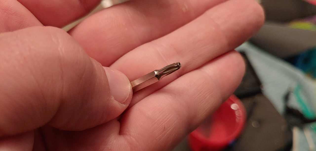

I'm having an issue with US made Spydies
Posts: 15698
Way too much loctite.
WAY too much.
I've disassembled four US made Spydercos recently. Siren, Chief rex45 and two Manix XL's. All had screws slathered in white loctite.
The Siren had tons of white loctite on all the screws. I had to boil water to soak it to get it to release. It was the most difficulty I've ever had taking apart a knife.
The S30V Manix XL had so much loc-tite it broke my torx bit, completely warping the head. Stripped a pivot screw in the process of trying to take it apart. It was honestly so bad trying to take it apart the first time I thought about selling it for that reason alone. Again I had to boil a pot of water to make the screws even consider the idea of rotating.
Tonight I tried to disassemble my Chief. I couldn't. Not with the tools I have. I managed to get the blade out, but I couldn't remove the stop pin by wrapping rubber around it and pulling it with needle nose pliers. Had to give up with that. Couldn't remove the steel backspacer because the rear body screw stripped as soon as I tried to do anything with it. This was after soaking it in boiling water before even attempting anything, based on my experiences with other US models.
This is starting to become a problem for me. I don't like the idea of breaking my tools trying to take apart my pocket knives. Never seem to have this issue to japanese models. My Police 3 is so easy to service I can take it apart in my sleep.

One of the Pivot screws on my Rex45 Chief was stubborn to the point it started to spin damaging the D hole on one of the scales. Had to put the other side back on to loosen it. But other than that everything else came apart ok.
A possibility here might be the torx set you are using. I find the Wiha Torx drivers fit very well. I never have issues with stripping. To the point where the G-10 strips before the screws do apparently. You might try switching brands.
I did also have trouble with the Chief stop pin. The tolerances there are 'press fit'. I used my lynch pry bar wraped in a micro fiber cloth to get it apart, and had to use a padded clamp to press it back together.

Without seeing the screw threads / residual loctite hard to say what’s too much, but if they are using the correct kind (blue or equivalent) then it shouldn’t be too much issue even if there is some excess.
You should consider investing in a quality torx bit set, that would solve most if not all of your troubles and if you really need to apply some heat try a soldering iron directly on the screw.

On the subject of torx bits (can't help with the dreaded locktite situation), I've read on another forum that some screws are "torx plus" IP6 or IP8.
So I bought new Wiha IP6 and IP8 bits, seems like there are some tolerance differences between some clip screws versus body screws for the t6/ip6. On some screws the IP6 fit tighter, then on other screws they are too tight to fit (on an endura and cara cara).
