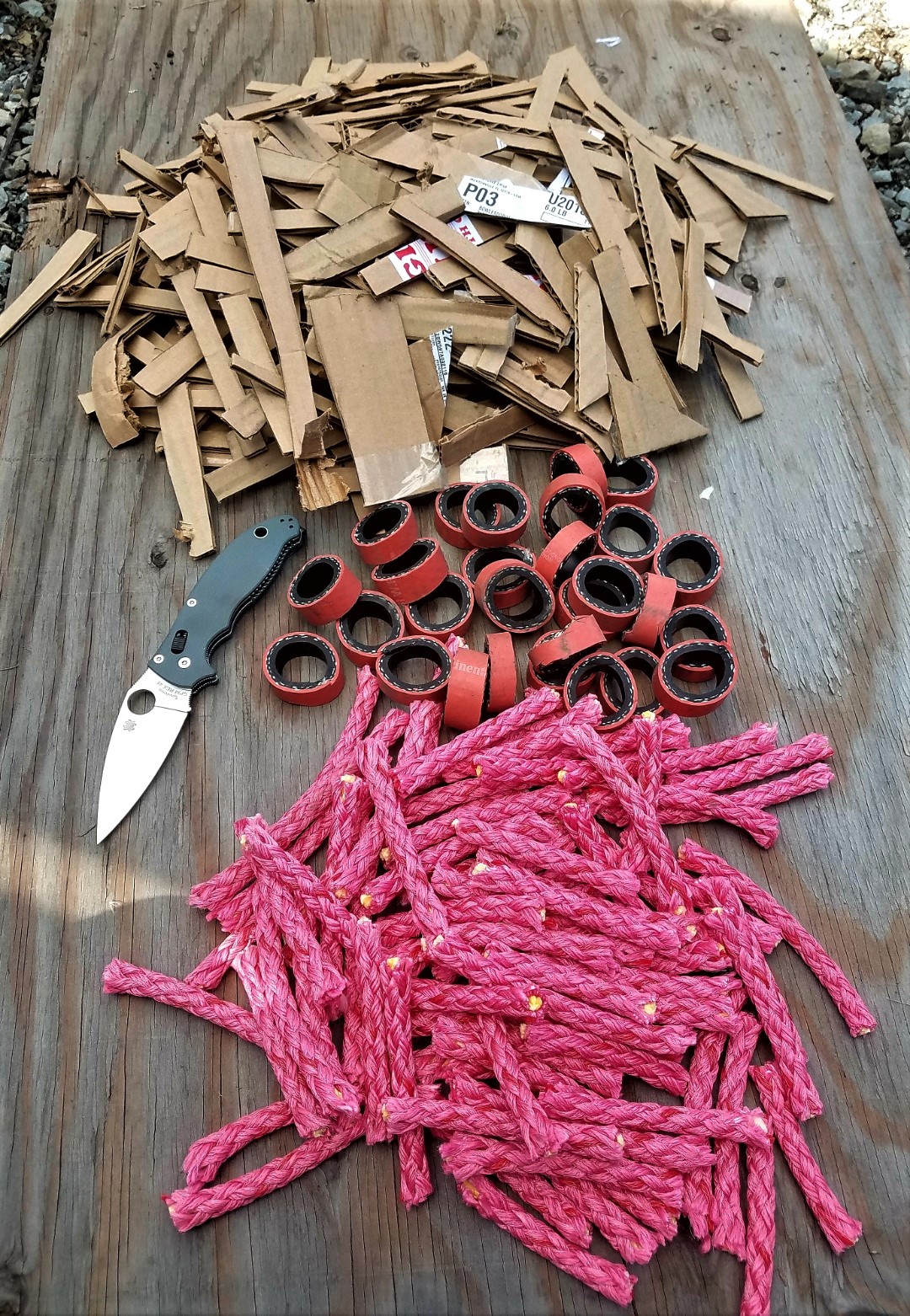

Quick wrap up for the week since I've got to leave work a little earlier than usual today. I cut up a bunch of rope that will be used as tarp tie downs here to cover some electrical equipment. Decided to chop into some more pallet wood on top of all the usual cutting for the week. The Crucarta Shaman performed well all week, no struggles in performance, which could be the model itself. The Shaman is A BAD KNIFE! :cool: To my surprise...Cruwear can't compare to 4V, not even on the same planet. I have gained a new found respect for 4V because of this.
As I said a couple days ago, the Cruwear seemed to dull and blunt on multiple spots in the blade earlier this week. It's tough to see, but in the second photo where the blade is propped in that sliver of wood...there are actually 3 tiny CHIPS in the blade! They could be rolls, but they really feel like chips. Visible when looking close and obviously when running your nail over them. 2 in front of the wood sliver and one behind it towards the handle. I'm not worried about it, as they are small...but wasn't expecting to see that. Tonight I'll see how well rounded Cruwear is in the sharpening department. I know touch ups are a breeze, and expect the same with sharpening out these small chips.
Sounds weird, and maybe totally against science and chemistry...but in the performance department, I didn't find Cruwear to be any better than S30V.

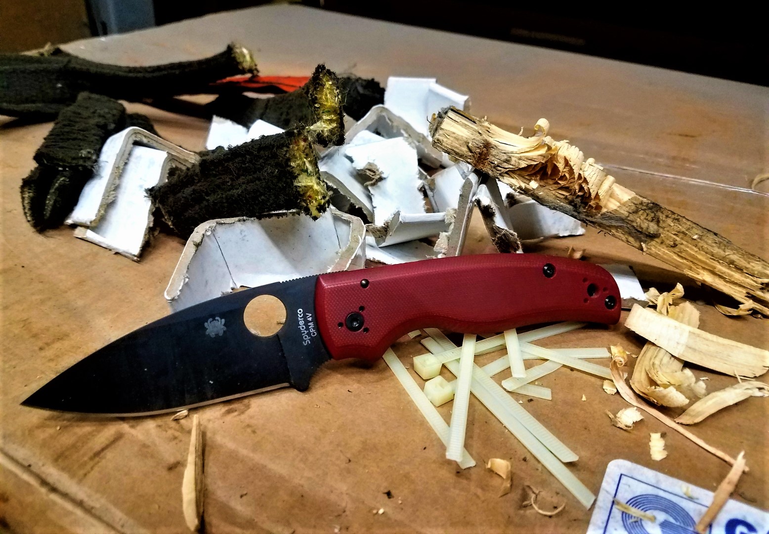

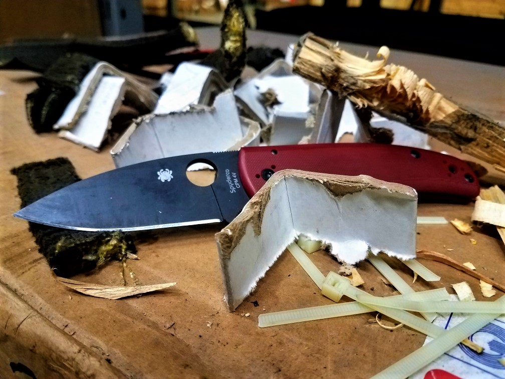

My weekly Friday close out post of the used all week for work knife. This week was the Shaman in 4V. I used it pretty much on par with the Para 3/M4 a couple weeks ago. With my end of the day free time, I decided to hunt down a couple different items to cut up to see how this steel performed to some of my previous tests. Before work today, the Shaman cut paper but not very clean...granted this knife isn't really known as a slicer anyways.
I cut up a few zip ties, sort of feathersticked a piece of pallet wood, cut through a bunch of thick corner board as well as a strap for hoisting motors and such that one of our maintenance guys was going to throw out. I was impressed with how easily it powered through the corner board, even the greasy hoist was no challenge. I posted a few photos below to try and help show the thickness of both items.
So on top of this stuff and the regular cutting for the day, it still slices paper about the same as it did this morning before work. Overall, I felt more confident in really cranking down on the Shaman going through the corner board than I may have, had I done the same with the Para 3. Wearing cut protective gloves, it's still extremely comfortable in hand. The lack of a thumb ramp made it more comfortable on the downward cuts when using pressure and not engaging in a hammer grip. In comparing the steels I've used since I've been doing these little reviews, for my kind of work I've found M4/20CV and 4V to all be pretty similar. I think I was more impressed with the Para 3/M4...maybe because I wasn't expecting the results to be as great as they were, where as with this knife I expected greatness...and got it.

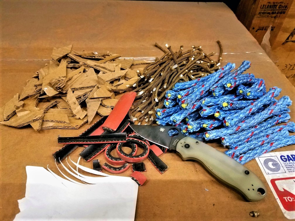

My weekly carry journey comes to an end today for the Para 3 in M4. I'm left thoroughly impressed! It was a fairly heavy work week this past week. I never once touched up the edge or gave it any passes on the strop. I finished up most of my work fairly early today and it was still shaving. The past couple hours I decided to try and dull the edge by cutting up various materials I can find around the warehouse.
Sliced up a few boxes into pretty small pieces, the brown paracord I cut 225 pieces. I used 75 cuts for the tip area, 75 cuts for the belly and 75 for the heel of the blade. The blue rope is heavy duty stuff, covered in a waxy finish to help keep it bound together. The Para 3 cleanly cut through those pieces while having to use a bit of strength looping the rope around my finger and pulling the rope towards myself as I push cut with the knife. Cleanly cut through every time on the first try. I finished up with various cuts of the heavy duty rubber hydraulic hose. My hand is now a bit cramped haha.
I ran my finger along the edge and it didn't feel very sharp. I thought, yes...I've defeated M4. I grabbed a piece of paper, and as you can see...cleanly cut it along the entire edge! I never really got to test the toughness of M4 I guess, but wow...this steel handled everything all week long, outlasted my hand in strength and still isn't done yet. I was very impressed with the results of the Manix 2 in 20CV a couple weeks ago, but I think M4 claims #1 of my weekly long tests so far.

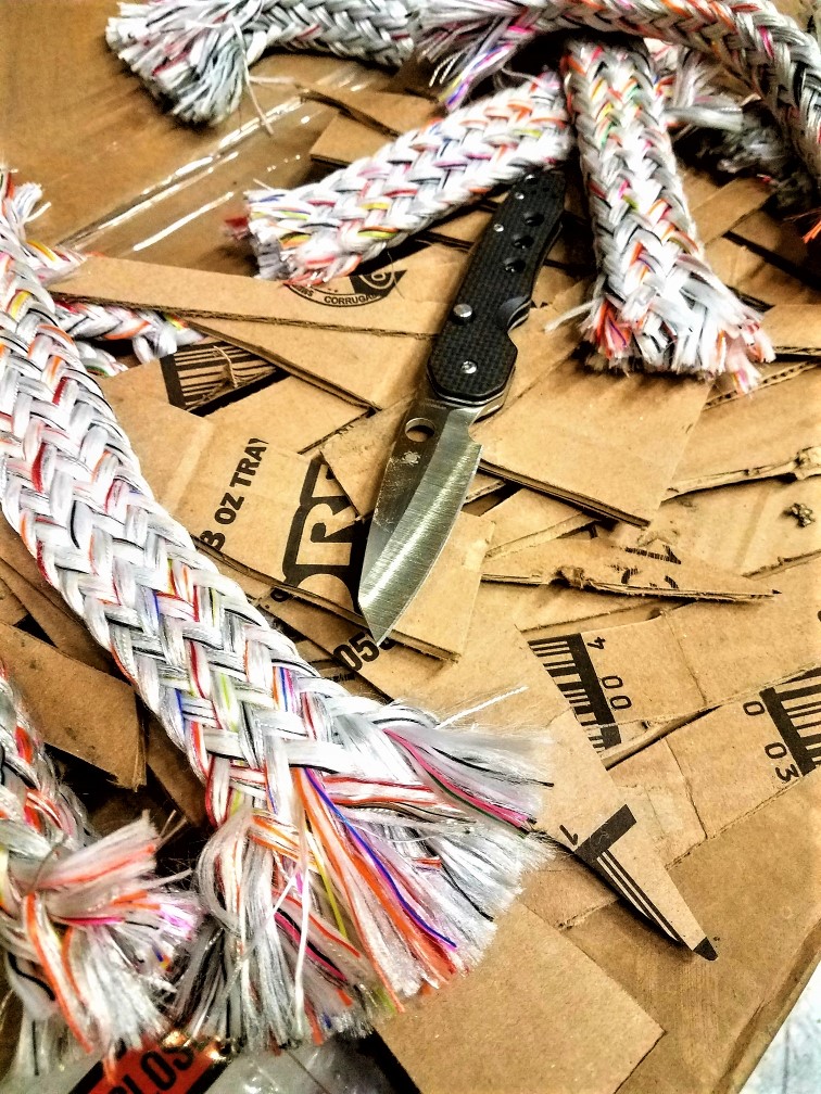

Finished the last 3 days of the week with the Smock in S30V after retiring the Caly Jr in Super Blue after 2 days. The Smock held up well, no problems cutting any of the typical warehouse type items. I really love how the Smock disappears in your pocket, takes up no space at all. I got bored a few minutes ago at the end of the day and decided to shred some cardboard and a bit of rope that was laying around...still cleanly cutting paper and shaving no problem after the past 3 days of use. S30V EASILY wins in warehouse duties over Super Blue, as well as the Smock over the Caly Jr (which was to be expected)
I also attached a photo of how I hold the Smock when using it. For me, this feels totally natural when using this knife and is quite comfortable. I know ergos tend to be a turn off for people when it comes to the Smock and don't think anybody should neglect this model without trying it for themselves first. Fantastic knife...awaiting some sprints!!
