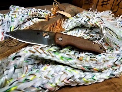

TkoK83Spy wrote: ↑Fri Mar 20, 2020 2:11 pmQuick wrap up for the week since I've got to leave work a little earlier than usual today. I cut up a bunch of rope that will be used as tarp tie downs here to cover some electrical equipment. Decided to chop into some more pallet wood on top of all the usual cutting for the week. The Crucarta Shaman performed well all week, no struggles in performance, which could be the model itself. The Shaman is A BAD KNIFE! :cool: To my surprise...Cruwear can't compare to 4V, not even on the same planet. I have gained a new found respect for 4V because of this.
As I said a couple days ago, the Cruwear seemed to dull and blunt on multiple spots in the blade earlier this week. It's tough to see, but in the second photo where the blade is propped in that sliver of wood...there are actually 3 tiny CHIPS in the blade! They could be rolls, but they really feel like chips. Visible when looking close and obviously when running your nail over them. 2 in front of the wood sliver and one behind it towards the handle. I'm not worried about it, as they are small...but wasn't expecting to see that. Tonight I'll see how well rounded Cruwear is in the sharpening department. I know touch ups are a breeze, and expect the same with sharpening out these small chips.
Sounds weird, and maybe totally against science and chemistry...but in the performance department, I didn't find Cruwear to be any better than S30V.
OFF WITH HIS HEAD!!!!!

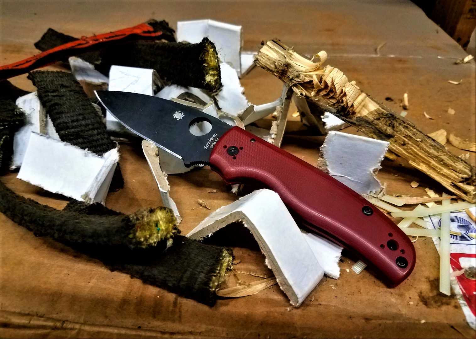

TkoK83Spy wrote: ↑Fri Mar 13, 2020 1:04 pmMy weekly Friday close out post of the used all week for work knife. This week was the Shaman in 4V. I used it pretty much on par with the Para 3/M4 a couple weeks ago. With my end of the day free time, I decided to hunt down a couple different items to cut up to see how this steel performed to some of my previous tests. Before work today, the Shaman cut paper but not very clean...granted this knife isn't really known as a slicer anyways.
I cut up a few zip ties, sort of feathersticked a piece of pallet wood, cut through a bunch of thick corner board as well as a strap for hoisting motors and such that one of our maintenance guys was going to throw out. I was impressed with how easily it powered through the corner board, even the greasy hoist was no challenge. I posted a few photos below to try and help show the thickness of both items.
So on top of this stuff and the regular cutting for the day, it still slices paper about the same as it did this morning before work. Overall, I felt more confident in really cranking down on the Shaman going through the corner board than I may have, had I done the same with the Para 3. Wearing cut protective gloves, it's still extremely comfortable in hand. The lack of a thumb ramp made it more comfortable on the downward cuts when using pressure and not engaging in a hammer grip. In comparing the steels I've used since I've been doing these little reviews, for my kind of work I've found M4/20CV and 4V to all be pretty similar. I think I was more impressed with the Para 3/M4...maybe because I wasn't expecting the results to be as great as they were, where as with this knife I expected greatness...and got it.

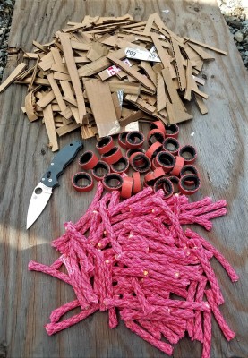

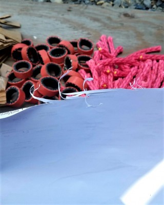

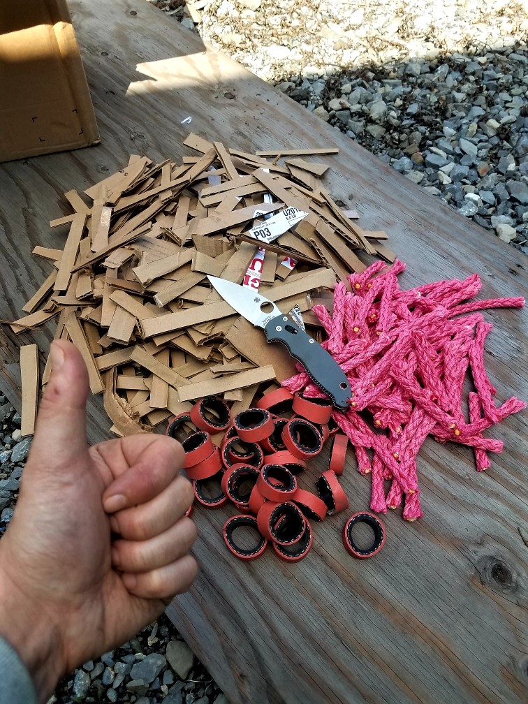

My weekly carry journey comes to an end today for the Para 3 in M4. I'm left thoroughly impressed! It was a fairly heavy work week this past week. I never once touched up the edge or gave it any passes on the strop. I finished up most of my work fairly early today and it was still shaving. The past couple hours I decided to try and dull the edge by cutting up various materials I can find around the warehouse.
Sliced up a few boxes into pretty small pieces, the brown paracord I cut 225 pieces. I used 75 cuts for the tip area, 75 cuts for the belly and 75 for the heel of the blade. The blue rope is heavy duty stuff, covered in a waxy finish to help keep it bound together. The Para 3 cleanly cut through those pieces while having to use a bit of strength looping the rope around my finger and pulling the rope towards myself as I push cut with the knife. Cleanly cut through every time on the first try. I finished up with various cuts of the heavy duty rubber hydraulic hose. My hand is now a bit cramped haha.
I ran my finger along the edge and it didn't feel very sharp. I thought, yes...I've defeated M4. I grabbed a piece of paper, and as you can see...cleanly cut it along the entire edge! I never really got to test the toughness of M4 I guess, but wow...this steel handled everything all week long, outlasted my hand in strength and still isn't done yet. I was very impressed with the results of the Manix 2 in 20CV a couple weeks ago, but I think M4 claims #1 of my weekly long tests so far.

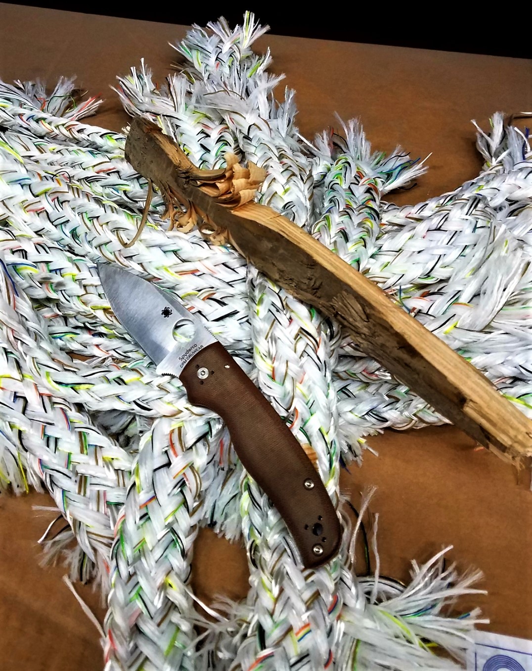

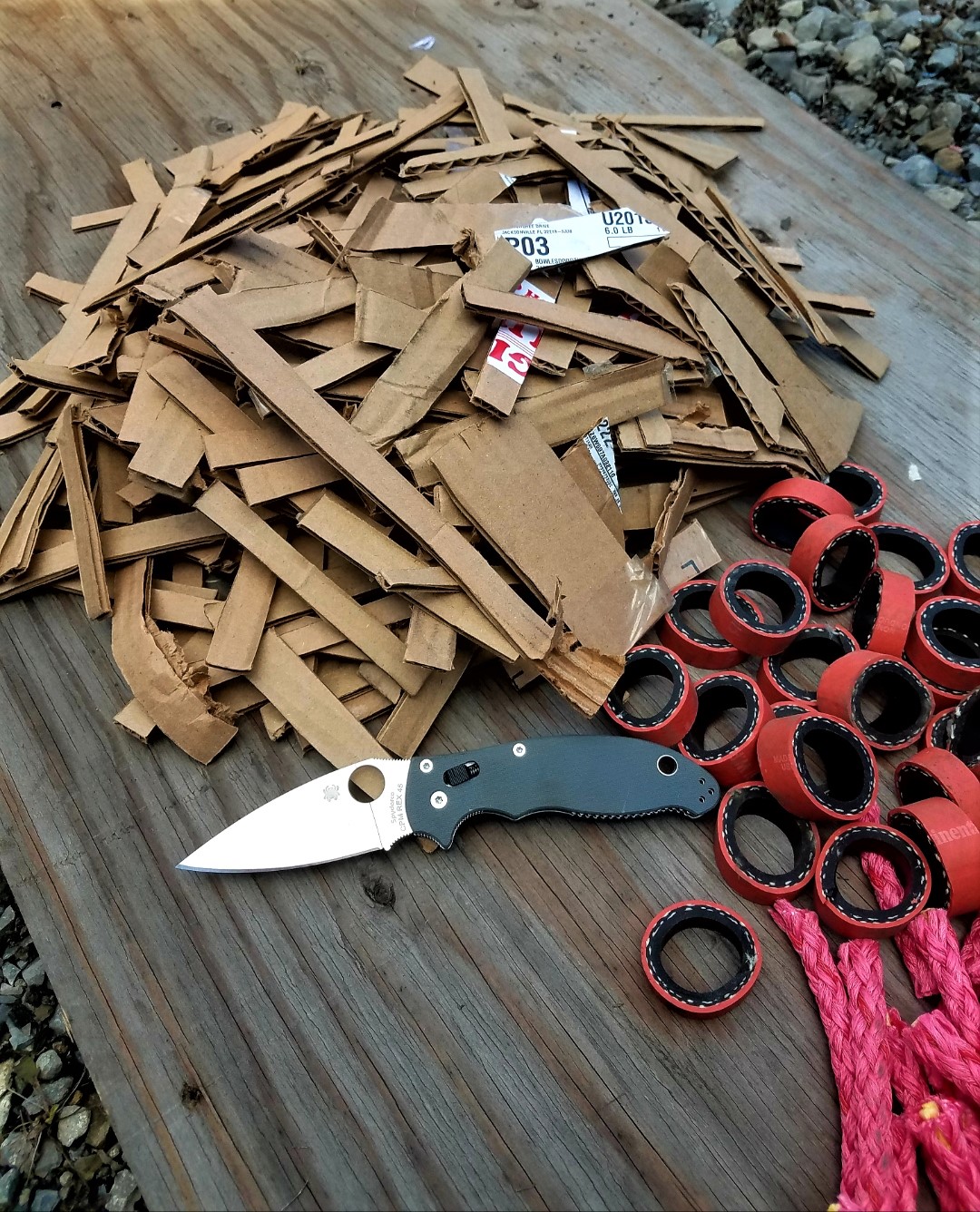

Right when I was thinking it couldn't get any better than the Shaman, especially in 4V...this guy came along. Rex45 Manix 2. Simply put, this knife performed as the #1 overall knife for me thus far through the 7 knives I've used in the weekly basis tests and I'd be extremely surprised if the 204P Millie, 52100 Manix, Matriarch 2 (haha) or Manix/Cruwear can surpass it. Not including the 3 knives I've reprofiled, as all these knives are the factory grind.
I'm sure it gets boring reading me ramble about the same type of stuff each week, but it's what's available for me to cut while at work. Not a huge variety of things...but at the same time, it makes it easier to more closely compare all these steels. I hope there's at least a handful of you that enjoy these reviews, as they do take some time.
During the "what Spyderco is in your pocket thread" I've mentioned how incredibly sharp this knife was out of the box. Though I gave it a couple passes on the UF stones and my strop for MY peak sharpness. It just seems to be so perfectly ground, I don't have another knife like it honestly. After the first 3 days of typical warehouse cutting, it still had that insane edge and I had a feeling it would already be the winner after 3 days.
So today I decided to do a bit more cardboard cutting that I normally do. I really should start counting what I'm doing, but I just get in a psychotic cutting rhythm that I don't think..to think :p I took various pictures to try and show the size of the piles I cut today, as well as the thickness of the items cut. Lots of cardboard, quite a bit of the hydraulic hose, as well as the rope. The rope is the same I cut with the Para3/M4, just a different color. Substantially less effort was needed for Manix today, it was a breeze. Could have cut for hours. Not to my surprise, it easily cut paper and even enough for the thin twisty pieces...which I've never been the best at cutting, but it can definitely do it if it were someone better at it than myself. After cutting the cardboard and through all the tape from the boxes, the blade was pretty gunked up but the hose and rope scraped it off and allowed it to really glide through those materials after the first few cuts through, when I was thinking maybe it was starting to lose that edge. Silly me!
Anybody that can find one of these, or on the secondary market for a reasonable price...you MUST get one. It's incredible!
My rundown through 7 weeks...

Great job Rick! This is the kind of knife review I like to see.
