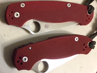

Thanks to Attila for the instructions and inspiration. I dyed my Cruwear Para 3 racing red last night. Here’s a picture with my M390 PM2. I used a little more dye and left them in the solution for about 30 minutes, but I don’t think the additional 15 minutes made much difference.
M390 PM2-Cruwear P3
M390 PM2-Cruwear P3
