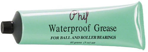

Get yourself some bearing grease when you put it back together. Trust me on this, it will make this knife smoother than it was when it was new and you won't have rust problems even if you put it away wet.
You can get this stuff at any bike shop.

Evil D wrote:Get yourself some bearing grease when you put it back together. Trust me on this, it will make this knife smoother than it was when it was new and you won't have rust problems even if you put it away wet.
Hey D, I've heard conflicting reviews on using grease on knife bearings. You find that works better than oil or dry lube? Do you have any issue with it attracting dirt gunk?
My knives generally don't see any dirtier use than cardboard or wood/camping type environments, and pocket lint. So far I haven't had those issues. My opinion with bearings is that anything that grease will attract will likely need to be taken apart and cleaned when using oil/dry lubes also. Basically, if it would gunk up a pivot when using grease, it'll likely also gunk up the pivot when using oil. Performance wise it's a night and day difference. I was so impressed I took apart most of my knives and put that grease in the pivot, and I was able to finally adjust my 20CP Para 2's pivot tight enough that there's no side play anymore, while the blade will still fall shut by gravity. Also consider that while grease may attract dirt/lint, it will also prevent rust, so it's all give and take.

I've used grease on bearings and find that it indeed gets dirt and gunk in there, however not much more than oil and it lasts longer,(for a fidgety guy like myself. open, close, open, close...) I don't use dry lube, tried on one knife with good but extremly short lived results. I can't remember what kind I used but had to reapply more times than it was worth. For me, pretty heavy grease is usually the way to go. I don't mind pulling my knives back apart for cleaning and regreasing.

Yeah I've thought about using grease, but first I'd like to see if I can get it back into shape without it. I run all my knives dry, even the Southard. It flew open effortlessly at first, but if there is enough damage and pitting that I'll never get that back again without the help of a lubricant, I'll do it. I'm going to take it to work today and check things out under a microscope to see what I'm working with.

Bearings require a lubricant. Period. In my 19 yrs of experience working in the trades I have never seen/repaired a bearing that didn't require it. I have replaced many that failed due to lack of lubricant, or contamination. Bearing material have and ultra high polish, maybe and chromium finish(not really sure but they have a nice polish anyway). Depending on the application, a grease is selected per application I.E. high speed bearings require high temp grease etc. They require an ultra smooth surface and and ultra thin layer of lube to ride on. The tolerances assure the grease is thin.
I don't think this bearing is shot by any means but thats only because its so light duty. We could debate grease all day and its true that a specialized knife grease is probably the ticket for an knife afi. Personally I would go to the auto parts store and get a can of white lithium grease and just give it a little shot from time to time. Wipe the excess free as I stated earlier, you only need what it takes to coat the rollers and cage. Experience says that this will trap the remaining rust and like use it as a light abrasive to finish your re-polishing work. It may take a few days of use but eventually you'll wonder why you ever ran it dry.

xinam wrote:Bearings require a lubricant. Period. In my 19 yrs of experience working in the trades I have never seen/repaired a bearing that didn't require it. I have replaced many that failed due to lack of lubricant, or contamination. Bearing material have and ultra high polish, maybe and chromium finish(not really sure but they have a nice polish anyway). Depending on the application, a grease is selected per application I.E. high speed bearings require high temp grease etc. They require an ultra smooth surface and and ultra thin layer of lube to ride on. The tolerances assure the grease is thin.
Hi Xinam, how do you apply the grease to the bearings? Do you disassemble the knife? Thanks.

I tried white lithium on my Brous SSF. Using the spray is messy. It seemed to work fine at first, but didn't last long at all, got "scratchy" after 20 flips or so. I tend to use a heavy grease from work, not sure what kind it is but it's used on wheel bearings for forklifts. It lasts a real long time, stays in where it should,(lighter grease or oil can ooze out and get messy). It does attract little grime but not really any more than other things I've tried. Since it does such a good job of staying on where I put it and not working it's way out, it only gets the dirt that works it's way in on it. These days the only knife I don't use it on is my Sebenza, it's works great but for some reason the knife loses that little "clink" when closing with it. I put the grease supplied with it back on and "clink".
