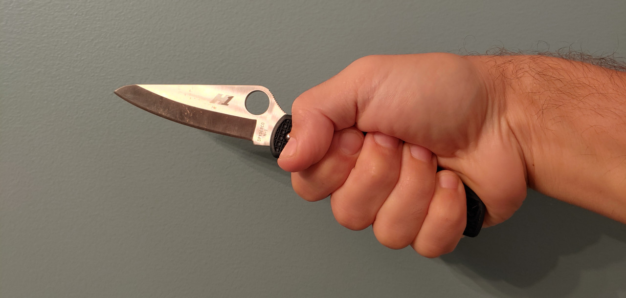

Here is the Chief LW compared to both generations of Pacific Salts:
Here are in hand photos of both the Chief and Pacific 1:

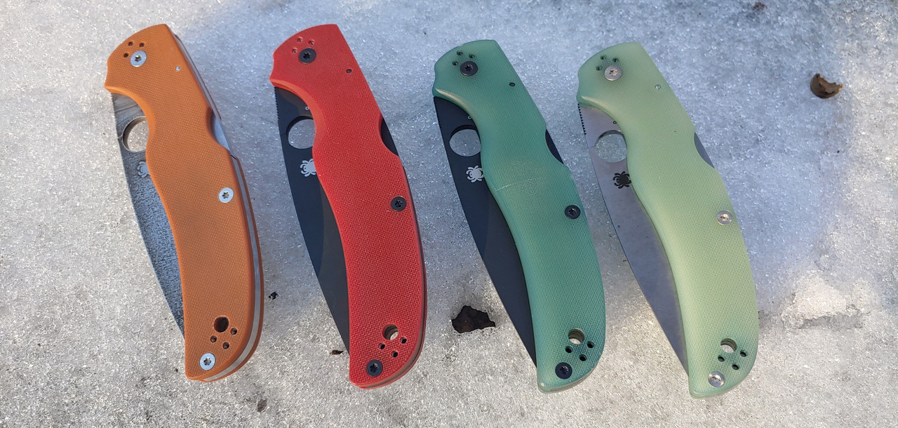

To date, my most used Chief to date has been the M4 DLC model.

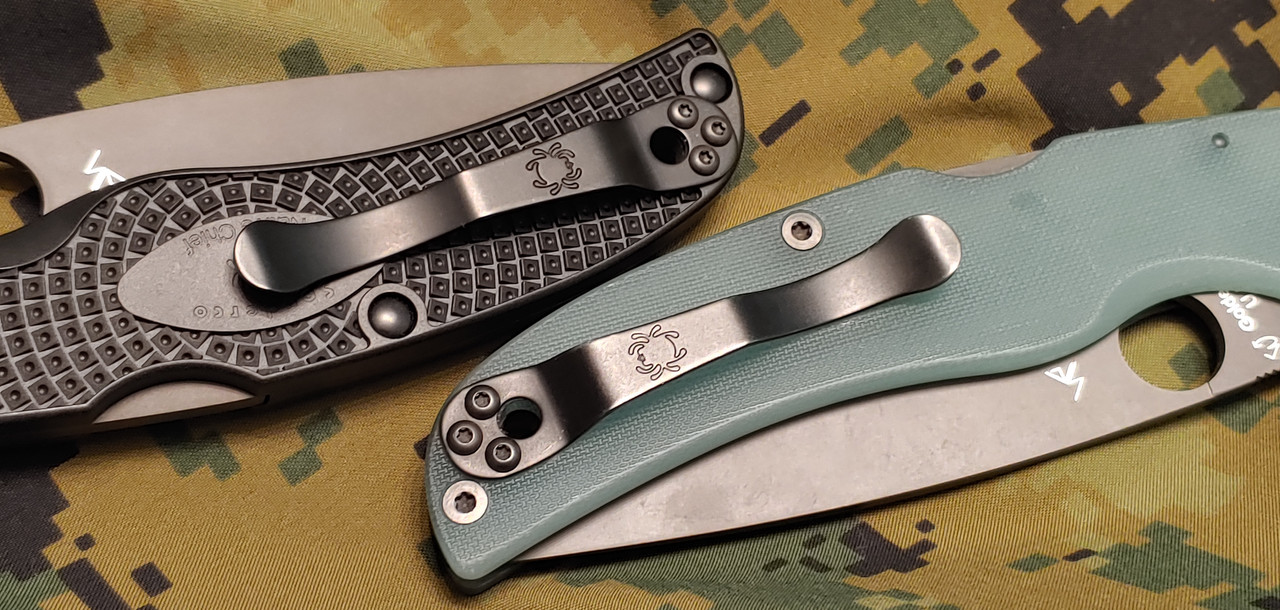

First, the clip. If you take a look at my thread from 2019 on the Police 4 Lightweight, you'll see I pointed out the clip contact pad on the handle was too short to work well with tip up carry. This seems to be an issue with some longer lightweight Spydercos.
The Chief is smoother going into and out of the pocket than the Police LW, but definitely not as smooth as either generation Pacific Salt, or my G10 Chiefs.
Video of the Chief LW going in and out of my pocket: https://streamff.com/v/3fa989d3
Video of the Pacific Salt 1 & 2 going in and out of my pocket: https://streamff.com/v/20ac496a
Now, in these videos I'm not using my usual technique. If I do that, things get even worse. Let's take a look: https://streamff.com/v/c17131e0
Yeah, not so great.
Again, I ask Spyderco, please extend the smooth contact pad a little further on larger lightweight models. The action of clipping and unclipping them feels worse than Delicas and Enduras. This Chief LW is better than the Police 4 in this respect, but not as smooth as a brand new Pacific Salt.

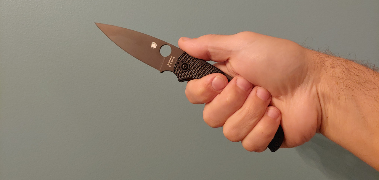

Let's take a look at the LW next to my hand sanded M4 DLC G10 model and compare their contouring:
I am pleased to report I give the out of box contouring a passing grade.
It does feel a little more squared and blocky in my hand VS my modded G10 Chiefs, but not so bad I feel like I need to sand the scales.

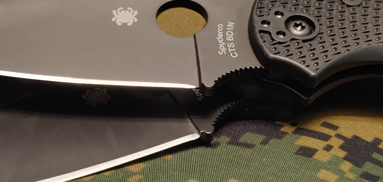

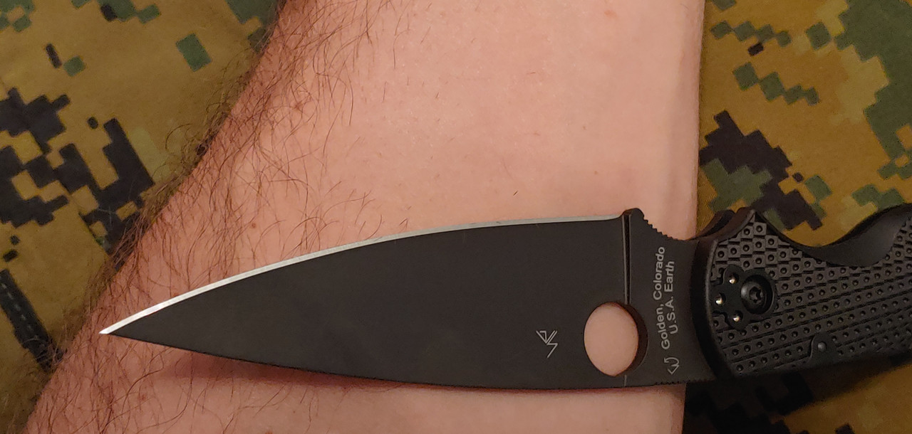

Something else I noticed, which was difficult to photograph at the base of the blades, is the Chief LW actually has a slightly thinner blade than the G10 version. You can see the difference in the tips:
The edge came shaving sharp, as expected:

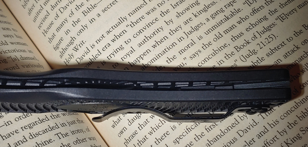

One interesting detail is the LW uses slightly different hardware than the G10 versions:
The scales are built much like the Stretch XL and Pacific Salt 2. They aren't solid slabs like the Pacific Salt 1:

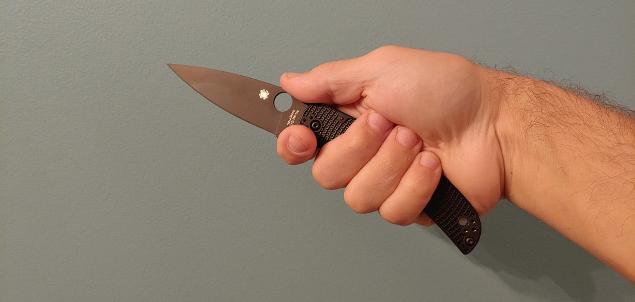

Lastly balance is perfect for someone like me who rarely chokes up:

2. A long aftermarket clip solved the landing pad issue. But this should have never gone to production this way.

Just a couple thoughts about the clip concerns you presented -
I’m guessing Spyderco has specific reasoning for the position and size of the flat pads on their FRN scales. Which could be a number of things but it seems like there are examples where it’s positioned to prioritize aesthetic balance and other cases where assuring the clip lands on the flat pad is the priority. In some cases they can conveniently do both. I just think there is more consideration to their positioning than it might seem at first glance.
Also not for nothing but the large oval shape on the Native Chief does seem like it accommodates both to a certain degree. I don’t have a physical example to verify at the moment but the flat oval pad does appear to extend underneath where the clip is landing. (Not entirely but it’s not entirely bidirectional texture underneath either) It does appear to be a bit of a compromise though and leans a little more towards the aesthetic side due to the body screw just above the flat oval pad.
At this point where they’ve already made so many FRN Native Chief scales with the flat pad the way it is, I think the easiest solution might be to adjust the size of the clip they include on the Chief. I would guess it’s more cost effective to change the size of the clips being made going forward than it would be to change the molds to fit the current clips.

They need a longer clip for the Salt PM2, so making a new, longer clip would make sense from that perspective as well.

Mushroom wrote:
Fri Oct 11, 2024 8:01 am
As far as I’m aware every forum member that has posted about this knife has reported the same problem. It doesn’t work.
Be careful with that tip. Mine either chipped a tiny bit opening a box or it came from the factory chipped out. It's a very, very chip that is hard to see. So it was probably the latter. But this is clearly an enthusiast blade, extremely thin and weak at the tip. That's great -- but it's very odd on a Native family knife.

zhyla wrote:
Fri Oct 11, 2024 9:50 am
Works just fine, as far as I'm concerned, even on sweat pants material. So, not a problem from my perspective. :bug-red-white

I had all the same issues: rough opening/action, clip too short and very slight chip at the tip. This reminds me that in the process of getting the pivot tightness balanced well, I had a pivot screw back out and get lost, which has never happened to me before. I've been waiting for a replacement, and thus haven't been able to use the knife for six or seven weeks now. I guess I need to make a follow up phone call today.
It doesn’t work.
What do you mean by “doesn’t work?”
It can’t be that the clip doesn’t extend over the flat oval pad at all - Because it does.
Also, context is important. If you didn’t just cherry pick one sentence from my post, you would have also quoted me noting how it looks like a compromise. It’s not perfect and I wasn’t disagreeing with anyone’s opinion. If someone doesn’t like the clip the way it is, that’s fine, it makes no difference to me but the fact remains that the clip does, at least partially, land on the oval pad.
Lastly, adjusting the clip tension is about as easy as removing it. That is a readily available solution to the clip not being “smooth” when removing it and putting it back in pocket.
“Doesn’t work” is a far cry from “being less smooth than other knives.”

The clip needs to be slightly longer. That would solve the problem.

Making new molds is obviously impractical. But the issue could be remedied with longer clips for knives like this and the Police Lightweight.
It looks like it's on the pad, but you need more overlap or pocket fabric snags, making it a very frustrating knife to carry. I see one response in this thread from someone who seems to think it works ok. I'm very curious about how it's working for them.
It's not about balancing the aesthetic -- of course the logo goes in the center -- it's that they cheaped out and didn't make a matching clip. Or -- worse -- didn't notice the problem in the design phase.
Mushroom wrote:
Fri Oct 11, 2024 12:56 pm
This approach assumes the clip lands inside the landing pad on a good design. When the fabric is bunching up on the scale texture it means the clip will slide out easily and be difficult to pocket. Not a great option IMO.
Obviously some people are pickier than others. Yes I can get this knife into my pocket. Am I willing to shred my pockets to carry this knife? Am I willing fight it every time? Not really.

Yep. The clip issue can be improved on large lightweight folders from Spyderco.
We can debate how big of an issue it is - but there is no debate that it is an issue.
Again, as price goes up, so do my standards. $40 folder? Whatever, I'll bust out some sand paper for the scales and bend the clip a bit in a vice. If I bought a $200 Magnacut Chief and had the same experience? Wouldn't be a happy camper.
It's weird. Spyderco knows to put smooth contact areas on their folders. They're aware it makes a difference. But for some reason they're choosing not to extend it to the optimal length, or use longer clips, on models like this and the Police LW.
I don't like bending Spyderco clips to reduce tension. I've never had one feel too tight. I have had them feel looser than I like. I'm quite active and move around a lot, and I like a secure clip. But I also like a smooth draw.
Bending the clip to reduce tension simply does not address the core issue. Extending the clip contact pad or lengthening clips does.
