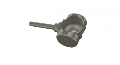

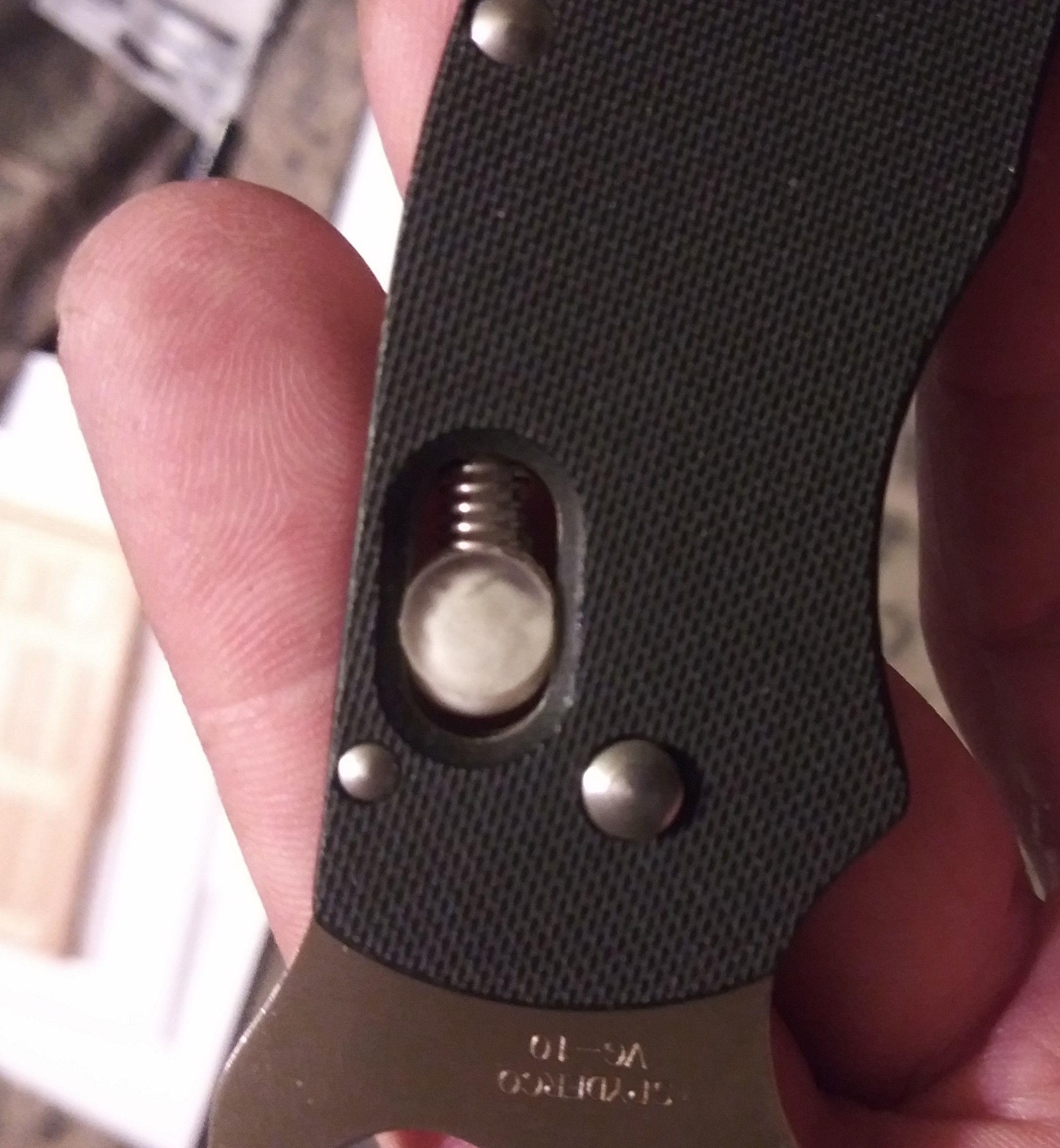

I mentioned this in other threads but thought it needed its own. This is one of those knives you should definently try first hand before buying. The only way to unlock a Q-ball is to use your thumb nail to get the ball to move because you can't grip it. The Manix 2 and P'kal use caged BB locks with smaller bearings. The cage gives you something to actually grab instead of a polished smooth ball bearing.

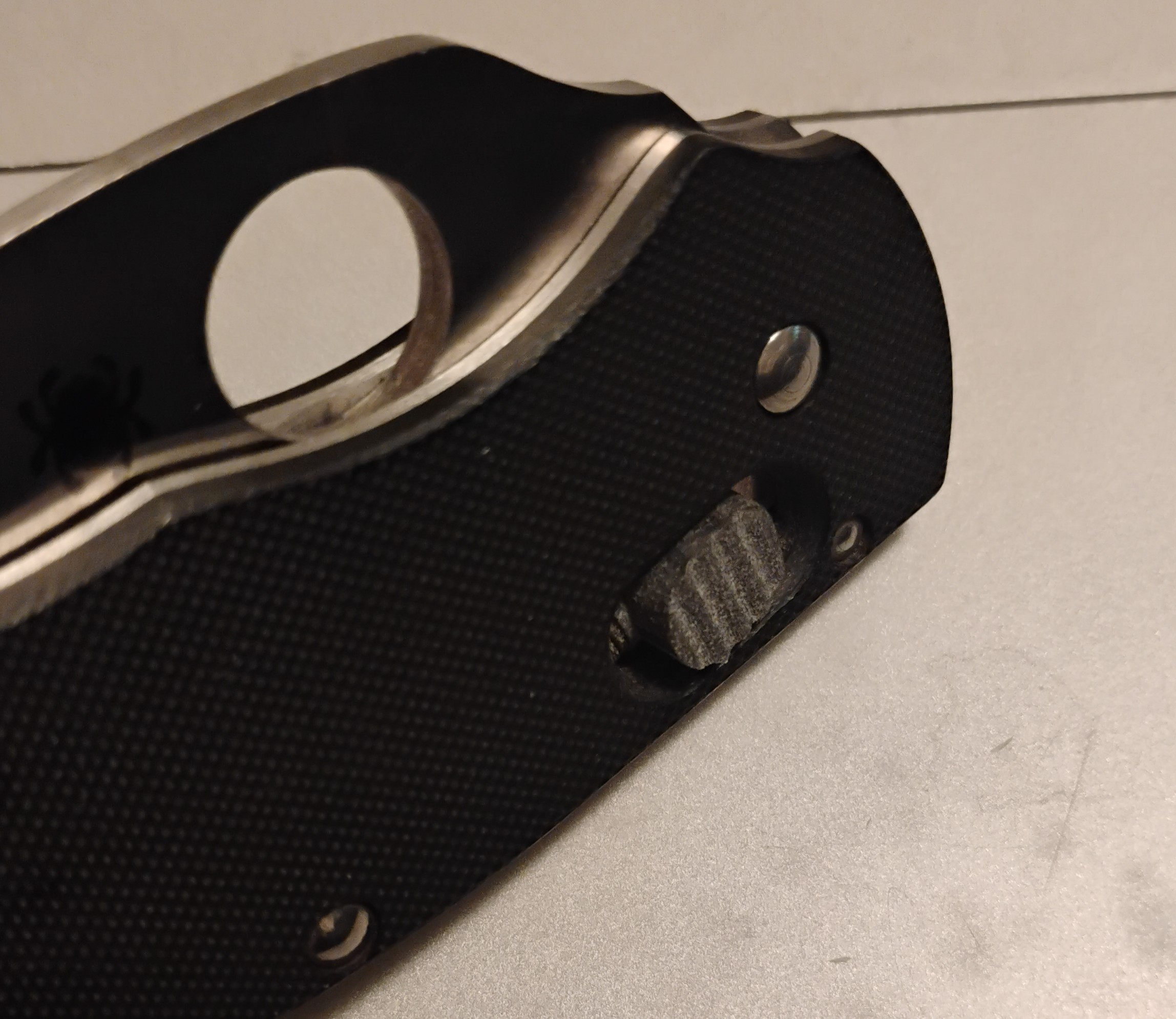

The resin printer came in handy because I went through about 8 versions before it was right. The cage was printed in clear resin but I didn't really like the look so I dyed it black, I guess it should be white so it doesn't look like an 8 ball. I have a bunch of different Rit dyes and red is going to be the first color I try then maybe blue. It still needs some small tweaks to strengthen it in weak areas but as a prototype it works great. With the last version I'm able to operate the lock with one finger as long as you don't fling the blade open with force because it causes lock stick and that could break this resin version. The end goal would be to have it cast in bronze or machined in some other metal for more reliability.

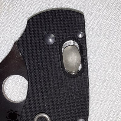

This is the newest version almost there.

Edit: This is it so far, I think it's ready just need some testing first. The supports were added in fusion because its a pain to get small objects to print without a raft but with supports. I got used to doing it when trying to get clear to actually print clear. The cage will more than likely need fitted to each individual knife so I put a little extra material in the weaker area. In my knife right out of the printer it will work but has a hard spot that only takes a little sanding to get it perfect.

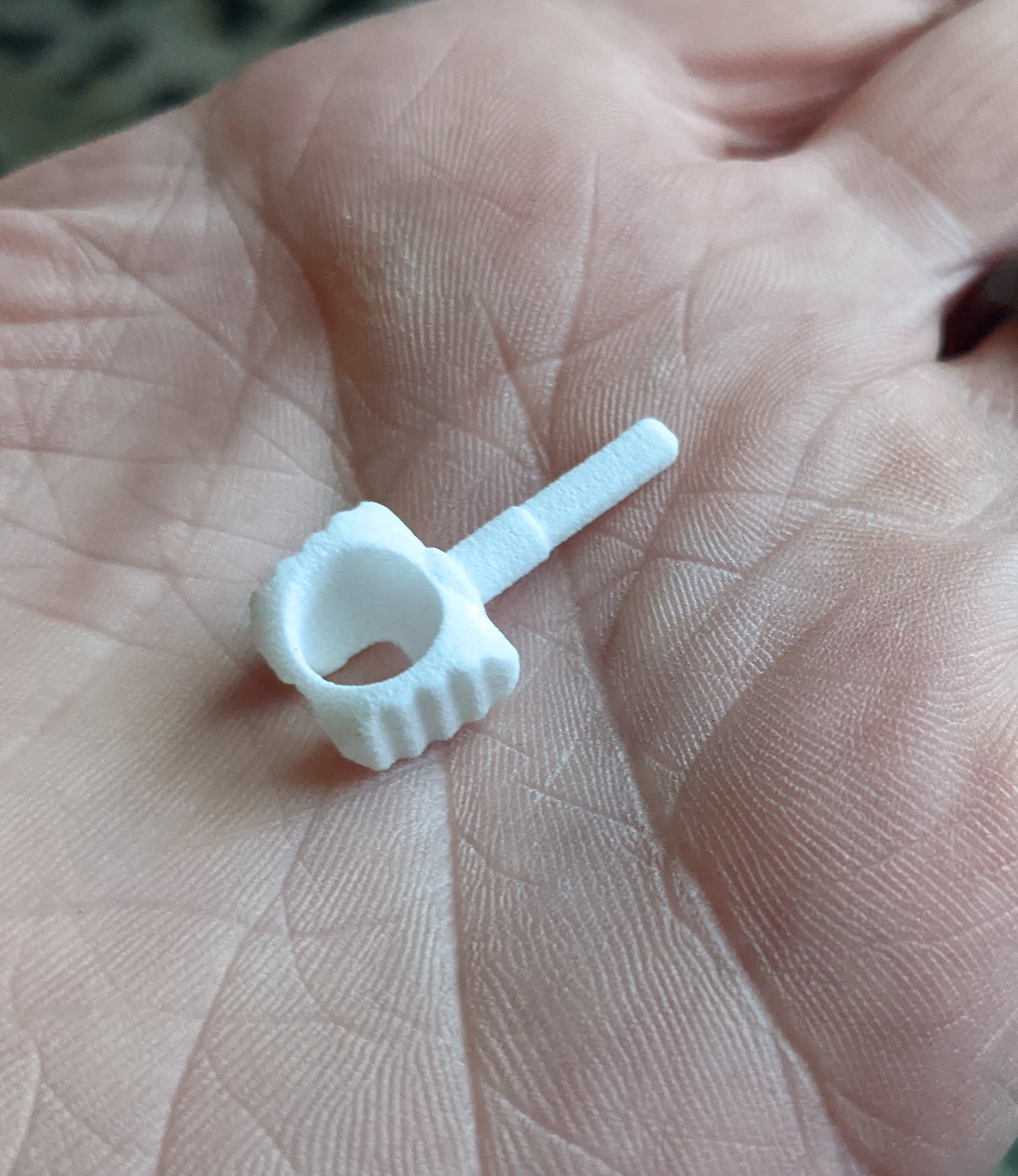

Newest revision SLS printed in Nylon 12. It's plain white color will work good since it covers the ceramic ball bearing. The texture is a little rough probably from the SLS process.

This is the latest version printed using HPs Muti Jet Fusion process in raw grey PA12S. Still had to do some hand fitting by sanding the top, bottom, and radius facing the blade.

Thanks. It's actually printed from nylon. I'm planning on trying Sculpteos cast brass for the next one.
