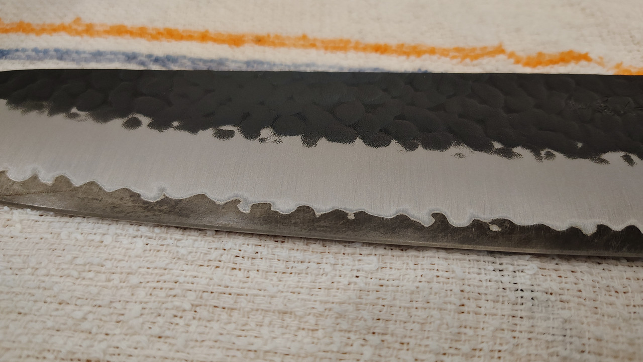

Diamonds go a long way to leveling this playing field. I don't look at this as a matter of difficulty anymore, it's more like one just takes a little more time than the next due to being more/less easy to grind. I think probably the common mistake a lot of people make is not dropping down to a course enough edge when sharpening, and the idea that you can simply touch up an edge all of the time is just not always true. Or to put it another way, you're making it more difficult and time consuming than it has to be because you're expecting to sharpen your edge with too high grit or the wrong media entirely. Some of the steels will technically be cut by a ceramic stone but it's on such a small level that you're closer to burnishing than you are cutting and then your touch up is more like steeling an edge straight and then there goes your edge retention too. People also don't talk enough about destressing their edge before sharpening, you need to get rid of all that old fatigued steel and cut a new apex. Think about how many times you can bend a metal coat hanger before it eventually breaks, the same thing happens to an edge as you dull it and touch it up on high grit media or strop it back to sharp. Eventually you need to remove that old steel and start fresh with a new apex. Edges are perishable.
yep. I always advise against people stropping back a dulled edge, or relying on them for deburring.
if you are going to strop, do just a few passes as the finishing step.
I can bring an edge back in less than 30 seconds with medium sharpmaker rods, so I'm not sure why some are so big on stropping things back. it tends to create a more rounded edge that lasts less than one off stones....for me at least.
even medium sharpmaker rods, specifically mine I ground down extra coarse, sometimes aren't enough.
every few touch-ups I refresh the edge and remove the microbevel if applicable on an 80-300 grit diamond plate, then finish with one or two strokes per side on the medium rods or my medium stone.
did this to a super blue gyuto last night. in the first picture you can see the bevel was clouey since I just touched up the apex on my medium bench stone for a few months. Refreshed the edge (poorly, I was rushing) on a 300 grit diamond plate, then finished on the same medium stone.
The edge turned out much better and more aggressive than the medium stone touch ups was resulting in.
funny side story. new guy at work took over prepping some peppers for me, then I had him dice some fresh mozz. between tasks I took this knife back and cleaned it and out it in my knife roll and gave him a kom kom chef knife. he asked, "different knives for different foods?" I said "no, $200 knife vs $10 knife. I'd be a lot less upset if you messed up this one ;)"
