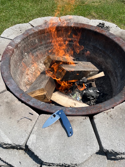

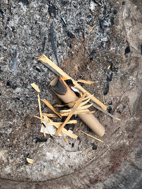

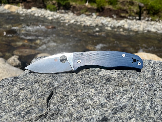

@sal I just wanted to follow up with you now that I have had some time with SPY27. I took the Bodacious with me on a 10 day vacation to the Adirondack mountains. The trip included fishing, fire pits, food prep, hiking, etc. I used the knife in all of these activities and it exceeded my expectations. I even pushed the steel using it to make feather sticks, light batoning and kindling. I even took the chance to grab a few pictures for the calendar.
The knife started with a fresh 16° razor sharp edge. By the end of the trip it was still fairly sharp and could slice paper cleanly. I had no rolling, no chips and no damage. When I got home I took it to a strop with 12 micron diamond compound on it and the razor edge quickly came back.
I am not sure if it was the new edge, the steel or geometry of the blade but I was beyond impressed. I am happy to hear you have a lot of SPY27 in stock but I will be very sad to see it eventually disappear. I know everyone compares it to S30V but in my experience it definitely exceeds it, especially with toughness/edge stability.

Thanx much for the feedback and pics on the blade steel. Robert Skibitski, metallurgist at Crucible deserves credit for creating the SPY27 blade steel.
