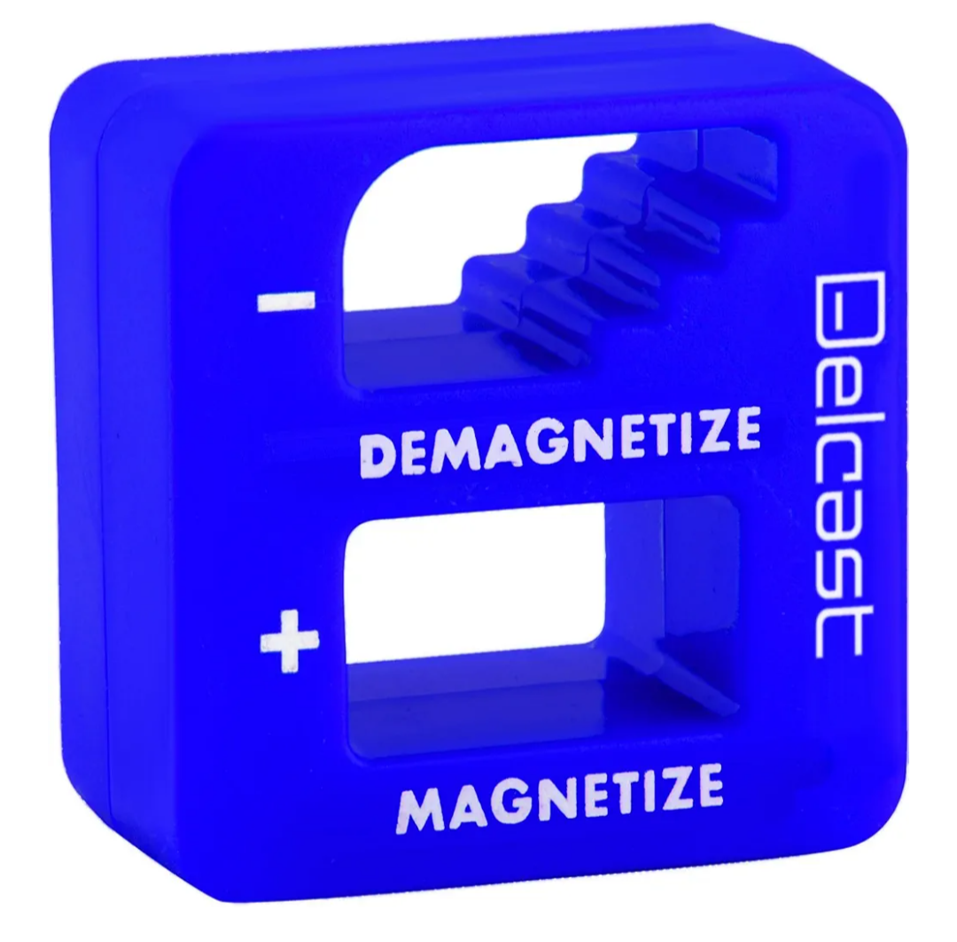

You can buy this magnetizing blocks for a few bucks at any hardware store.
There's a lot of factors that can cause materials to magnetize for apparently random reasons. They're not really random, but we're just not paying attention to all the little things that are constantly going on around us.
The need for that demagnetizing block is a perfect example. How many times are you working on some tiny contraption, you pick up a screwdriver, and the little screw just sticks to it? How many times are been working in the dirt, and you find tiny flecks of iron stuck to your tool? They're a bear to get off!
It's really kind of cool that just sitting here in front of our computers or phones, we get to see first hand an experiment in electromagnetism.

Pretty normal from the grinding, and easy to accidentally magnetize part of it from quick contact with a rare earth magnet on something.
You can get relatively inexpensive powered table top demagnetizers that you can quickly run metal objects over to remove it if it bothers you, those small tool ones won’t help you at all with larger items like a pocket knife.
