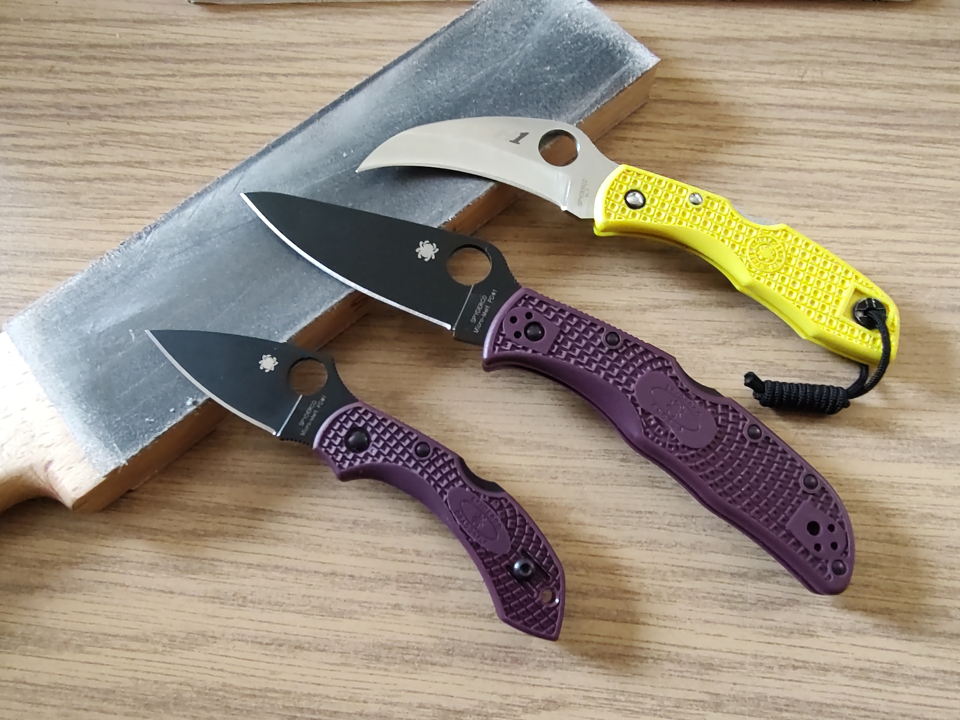

My favorite to sharpen are the sprints in Micro-Melt PD#1. It's easy to get a beautiful and razor sharp edge.
My hardest Spyderco to sharpen is my Tasman 1 in H1. But thats because it's a hawkbill and I don't have any rods, only diamond stones and a paddle strop.
