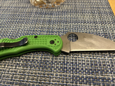

Post by spydergoat »
LC200n steel, when used in a folder, turns the handle a very nice green color. But, I noticed it doesn't do that in fixed blades.
cycleguy
Posts: 1555
Location: Arvada, coloRADo
Re: Some Steel better for folders than fixed blades?
Post by cycleguy »
Didn’t take to LC200N Mule while LC200N Salt 2 is a favorite. Not certain what this means, if anything at all.
CG

spydergoat wrote:
Fri Nov 15, 2024 12:40 am
Exactly

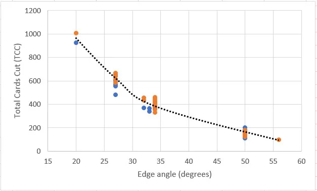

Evil D wrote:
Fri Nov 08, 2024 8:41 am
Depends on intended use.
If a folder is not built for hard use, then what benefits are you really getting from a super tough steel? Less edge damage? You can work that out with edge angles.
I don't have the experience to back up what I'm saying, just an observation from sources such as Larrins website and Cliff Stamp Youtube, so please view the following as a question not a statement:
Wouldn't managing poor toughness with and increased edge angle defeat the purpose of a high edge retention steel?
From Larrins graph going from 15dps to 22.5dps halves the edge retention.
If the ingredients for a stable low edge angle are hardness and toughness then presumably the steels that achieve both e.g. Cruwear, M4 , Magnacut etc run at their minimum stable angle could outperform the fragile edge retention kings run at their (higher) minimum angle? Depending on how much the increased toughness affects the minimum edge angle.
If you choose to run these "balanced" Steels at higher angles you still have acceptable edge retention but gain bonus resistance to edge damage caused by real world factors such as cutting dirty material (which these high edge retention steels seem to be vulnerable to) Refer Cliff Stamps criticism of 10V for context:
