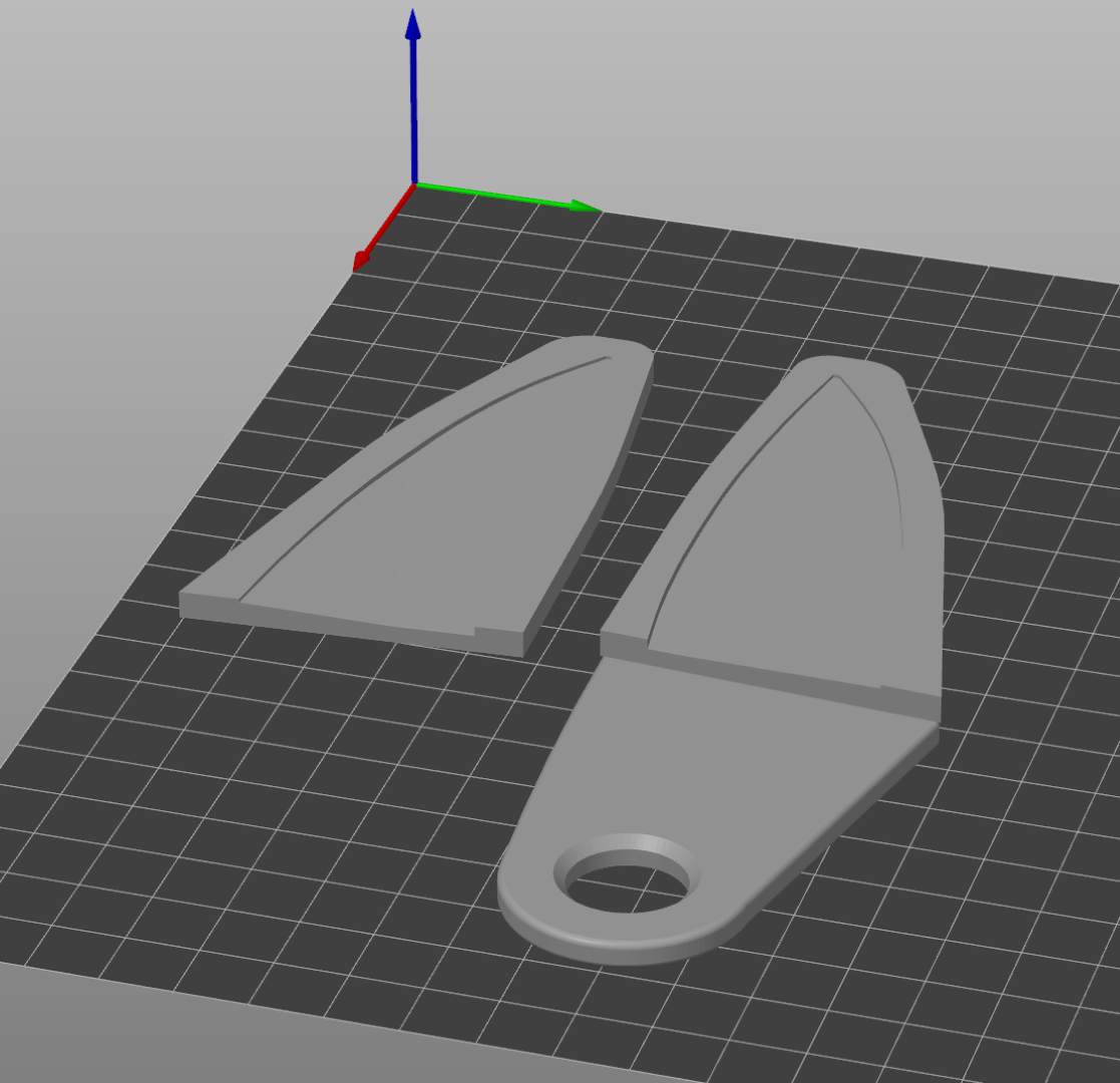

First proto for a SPY27 mule, one of many I'm sure. Long way to go till its useful.
Used the slicer to split down the center of the blade cutout & flip one side over.
Otherwise the blade cutout volume would have been a hot mess.
Took about 95 mins to print in PETG, 0.15 mm layers, 180 mm/s, 235/ 70°C.
Need to redo the backside dog leg with a heat gun, its too big as is.

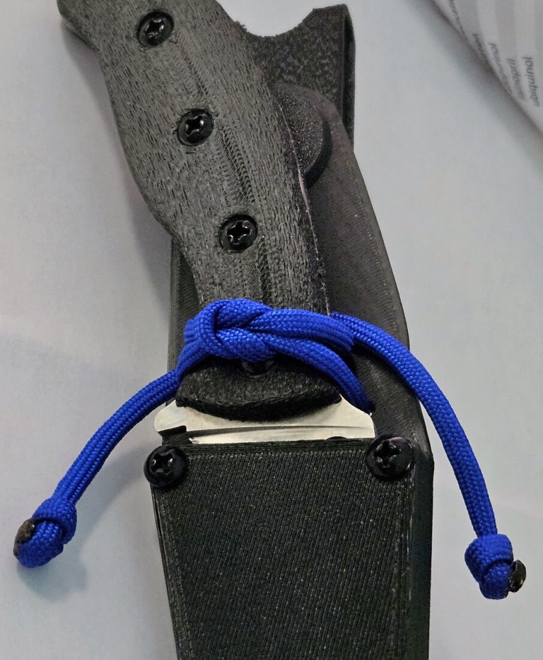

This is interesting! Do you have a plan for how you want to get retention on the sheath?

Neat, that looks like it is getting there. Maybe if nothing else a strap on the handle could be an easy way to help hold the knife in. I've been messing around with leather sheaths, but this is cool too. If I had a 3D printer I would probably do a little experimenting myself.

Very secure - could be leather cord - only requires 2 holes.
But not practical - too much effort to untie - so not quick deploy.

I like how simple that is at least. Just using a slipped knot instead may be secure enough while still allowing quick access. You have to bother tying a knot to secure it, but for how simple it is it might not be half bad.

Slip knot is a great idea, TKS SG
Quick go with that knot, looks & works better.

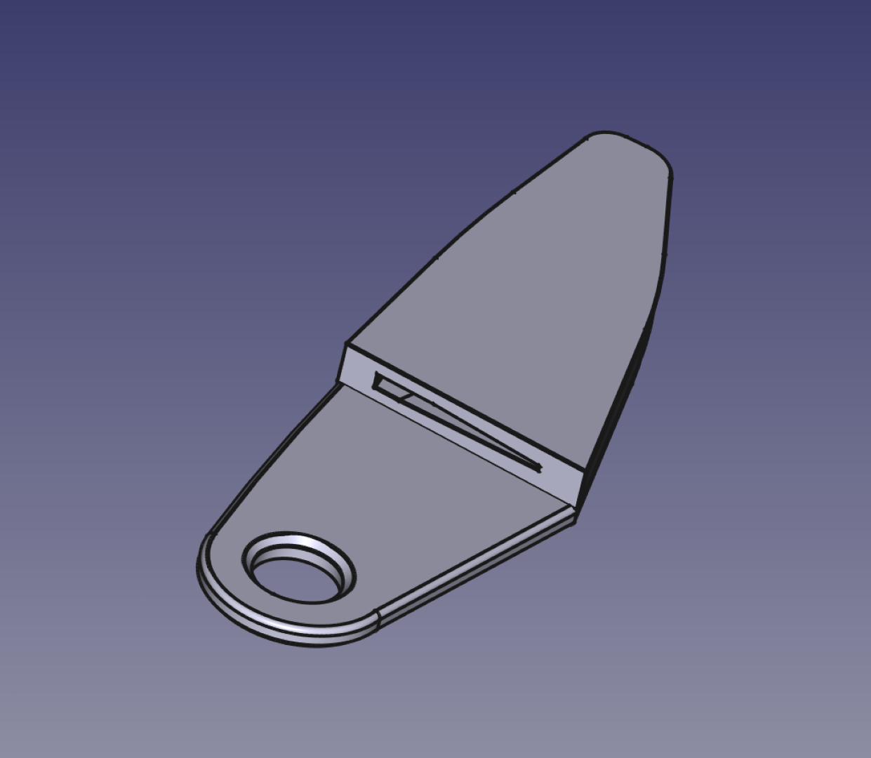

Great idea ChadR, as usual, there are complications, one is my current design is split in the slicer.
Will look at a redo to split in FreeCad, plus add the retaining tabs - may take a while, but worth it !
I printed the suggested sheath with tabs for a reference.
After a closer look at mine, the two upper screws are in key locations for strength, while the other retaining
tab flex cutouts would compromise those areas. I need to work on it a bunch more, its not a quicky..
