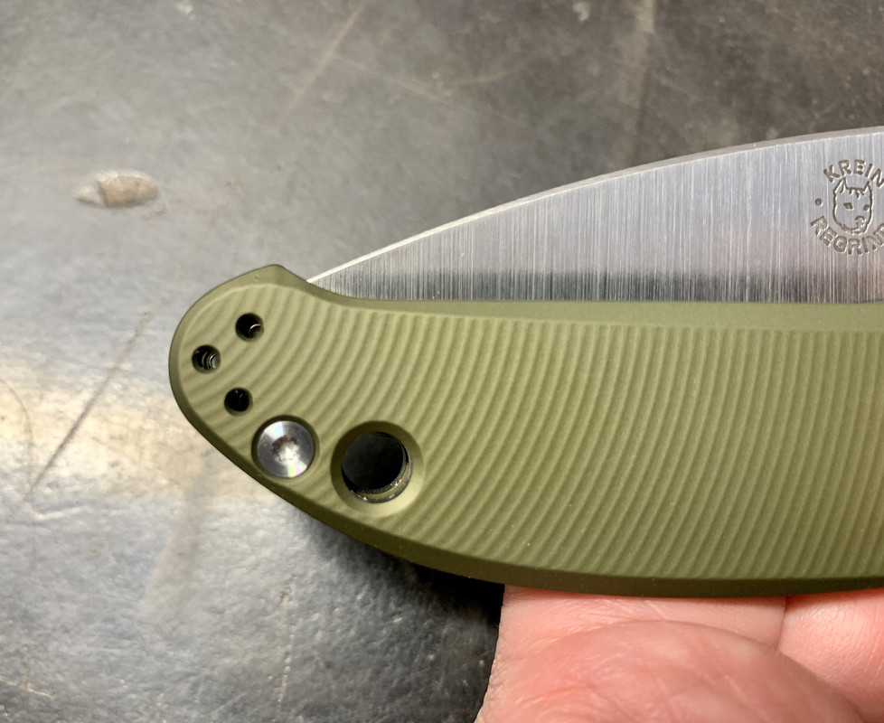

Not sure if this has been covered but I recently purchased some applied weapons tech scales for my BladeHQ Teal Manix 2 LW and after assembly I noticed that the tip of the knife if dangerously close to sticking out with the new scales. Its close enough that if you lightly run your finger over the butt of the knife you can feel it catch on the tip. Has anyone else run into this issue before with these scales? I'm just trying to figure out if this is just how they made them and getting a replacement set isn't going to solve the problem or if I got a lemon set of scales. The new scales look and feel great but I'm not fond of the tip being that close out where it can easily catch on stuff.

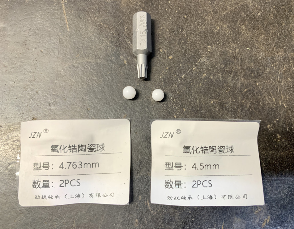

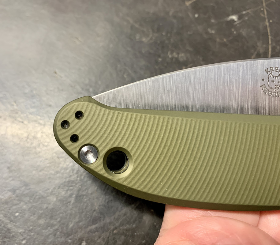

I've encountered this before on a G10 Manix with AWT scales. I fixed it by installing a slightly smaller ball.
Brock O Lee wrote: ↑Sat Mar 04, 2023 9:25 pm
I mentioned I was waiting for a slightly smaller ceramic ball bearing to install into my M4 Manix. I wanted to lower the blade tip in the handle, after I installed the AWT scales. This will give you an idea what effect a small bearing size difference has on the tip position of the blade when closed. The longer the blade, the more pronounced the effect.
Zirconia ceramic balls in 2 sizes, stock size left and slightly smaller right. T15 Torx bit for reference. I doubled-checked these diameters with digital vernier calipers before installing and they were spot-on.
Tip position with stock ball installed. Tip is barely hidden inside the scales. It is exposed enough to catch the flesh of my finger tip.
Smaller ball installed. Tip is nested much deeper inside the scales. No cut risk.
Both balls fit equally well into the ball cage.

I bought these Zirconia ceramic balls on Ebay.
