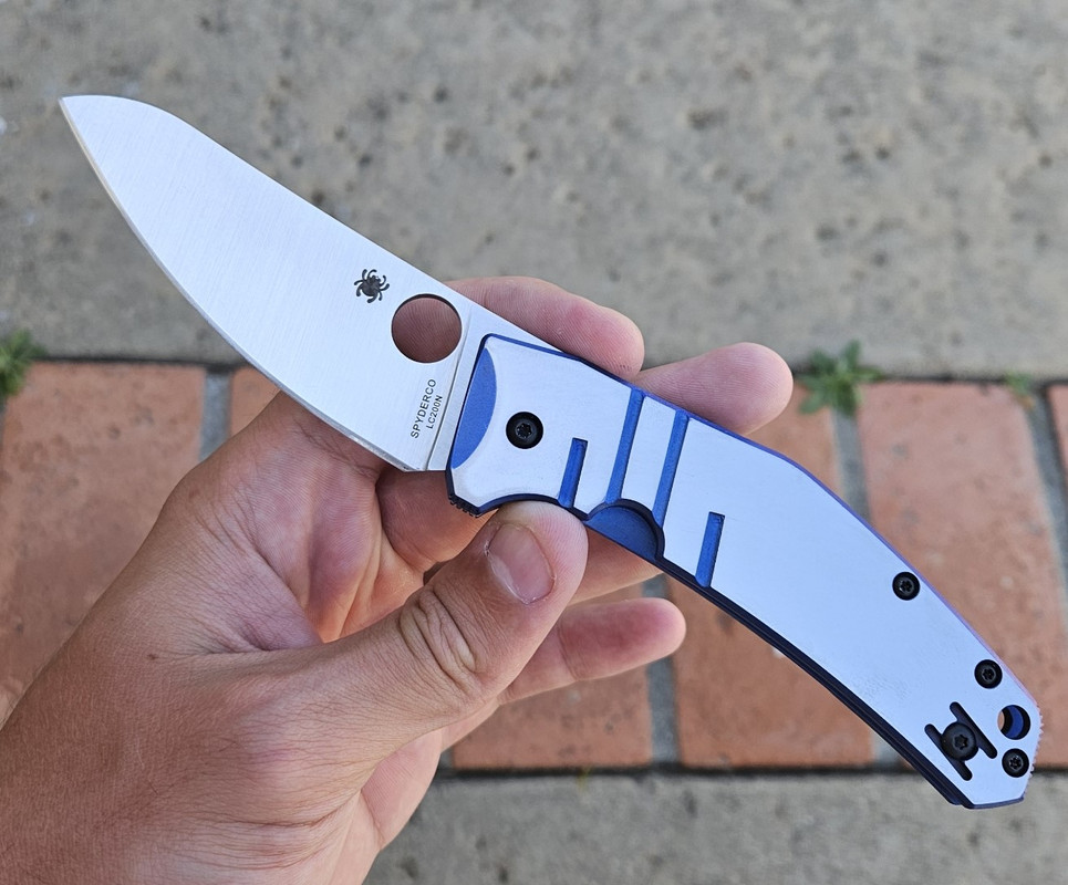

I just yesterday put a mirror finish (close enough) on my spydiechef.

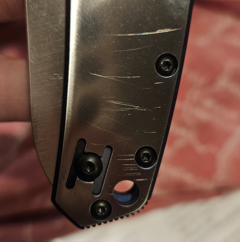

However while just now using it, I noticed some brazen horizontal scratches, which were extremely concerning to see. After all, since finishing the mod work, I've literally only picked it up for pictures and placed it down on my display stand (made of wood). Where did these come from?
Well, as it turns out, wood can scratch titanium! I confirmed by further ruining my finish with another wooden item. Kind of a frustrating way to find out - hand sanding is a real pain. But, now I know, and well they do say knowledge is priceless...

I don't think you're actually scratching the titanium itself, because it is one of the hardest metals known to man. However, I do believe that what you may be doing is transferring wood to the titanium finish, not scratching it. I can't comprehend wood of any sort could actually scratch something as hard as titanium. It seems physically impossible. I also be nuts and totally wrong.
The titanium used for knife scales isn't super hard. Ti handle scales will show wear and scratches over time. I'm kind of impressed the OP went for a mirror polish... my bead blasted Chris Reeve handles show wear, I can't imagine trying to keep mirror polished titanium pristine.
Edit to add: I don't want to make it sound like ti scratches crazy easy, but it does wear and a mirror polish on any material makes scratches show that much more easily.

Huh? When did that happen? Last time I checked, titanium Rockwelled out around 42 to 43. That's why people want steel lockbar inserts on their titanium framelocks, to keep the lockbar from wearing down, not to keep it from wearing down the blade.
Any wood that has been sanded can have abrasive grit imbedded in the surface, and that will be way harder than titanium.

Ti is tough, not hard.
It galls easily and so will scratch before any steel does, stainless or carbon.
I have glass bead blasted 6AL4V and it "seems"to toughen up the surface. It will still get scarred.
Accept the marks as scars of honor.

Coming from car detailing this doesn't surprise me in the least. Out of curiosity was your wooden stand wiped completely clean before placing the knife on it? Is it finished with polyurethane or another coating that could become embedded with dust and other air born contaminates that settle on the surface? Just because a material is harder on the mohs scale than another material doesn't mean it can't be scratched by the softer material. I would imagine this is closer to marring than scratching, but due to the mirror polish it is extremely noticable. If it's a safe queen you could line your knife stand with plush microfiber, but even that would just be preventive and not a guarantee. Handling the knife in anyway would run the risk of scratching and marring, clipping it in your pocket for the day would likely ruin it.

Did the wood get on the blade too? Because I see the same marks on the steel.
This looks like it was kicked across a cement floor. Or something similar.
I have nearly an airplane worth of Ti and it gets snail trails with time it doesn't mark up like this.

Titanium alloys like the one Spyderco uses (6Al-4V) have fairly low HRC values of 25—40 (6Al-4V HRC is 32). More pure Ti (grades 1-4), depending on its level of purity, has much higher HRC values of 70—100.

The grades 1-4 are on the HRB scale,NOT HRC scale.
The B scale is way softer.
The added elements in the higher grades increase their hardness and toughness.

I purposely raked the scales on the stand a little bit during my investigation. I knew I was going to refinish it anyway.

I did make sure there wasn't anything on the stand before retesting, same result.
What I will say is that the scratches didn't behave anything like normal scratches. Disappeared basically as soon as I started refinishing, which was a relief to my arm...

Is there any chance there is abrasive dust residue on the scales and rubbing them on the furniture just pushed the dust around and scratched the titanium? That’s a lot more likely than wood or polyurethane scratching titanium.

One grain of sand on a wooden surface is enough to scratch metal! My iPad is a testament to this!
My only experience with polished titanium is on the original PITS slipjoint. I dislike how easily it picks up fine scratches, however it is easy to remove them with a green Scotch-Brite pad to leave a type of satin/brushed finish.
