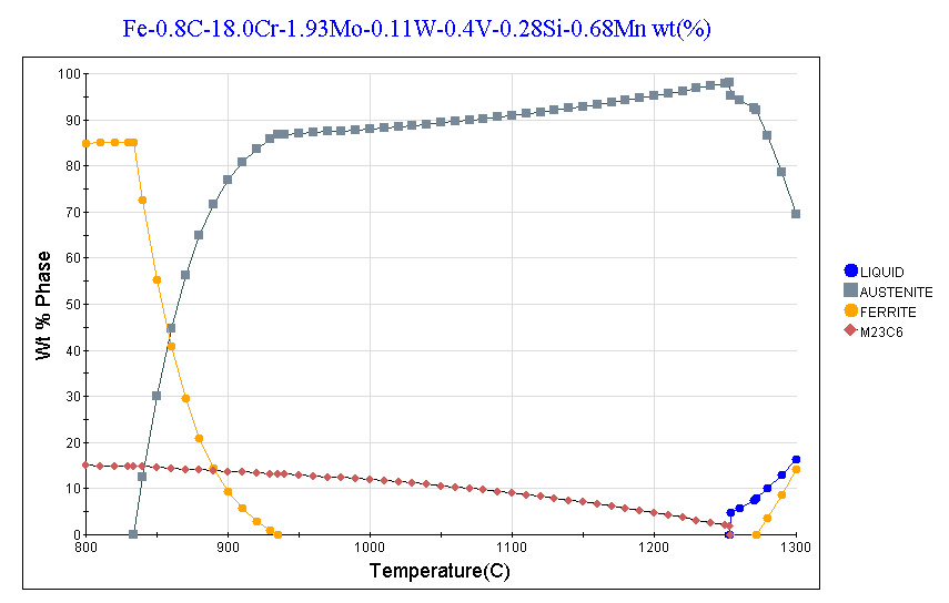

With this amount of vanadium, it does not form vanadium carbides. Vanadium dissolves in chromium carbides. Some of the vanadium will be in the iron matrix, some will remain in chromium carbides. This amount of vanadium is unlikely to have much effect on wear resistance.p_atrick wrote: ↑Fri May 31, 2024 4:25 pmWhat about the vanadium? There is more of it, but less carbon. I know that alloying elements "compete" with each other to bind with carbon. Is there any indication that VG XEOS could have more vanadium carbides? If vanadium remains in solution, what does that mean? Does it help in other ways?
If you carry out the calculation in JmatPro, you can get a funny result on the composition of the phases (after hardening the steel). If we take the average composition of elements, then steel contains a large proportion of ferrite, which is not very good.
But if you take the maximum carbon content and minimum chromium content for calculations, then everything turns out well and you can evaluate this steel. I think the last option is more like the "true composition". For now we can make such a rough estimate. At its core, this new steel is a modification of 440A. With slightly greater corrosion and wear resistance and comparable maximum hardness.
