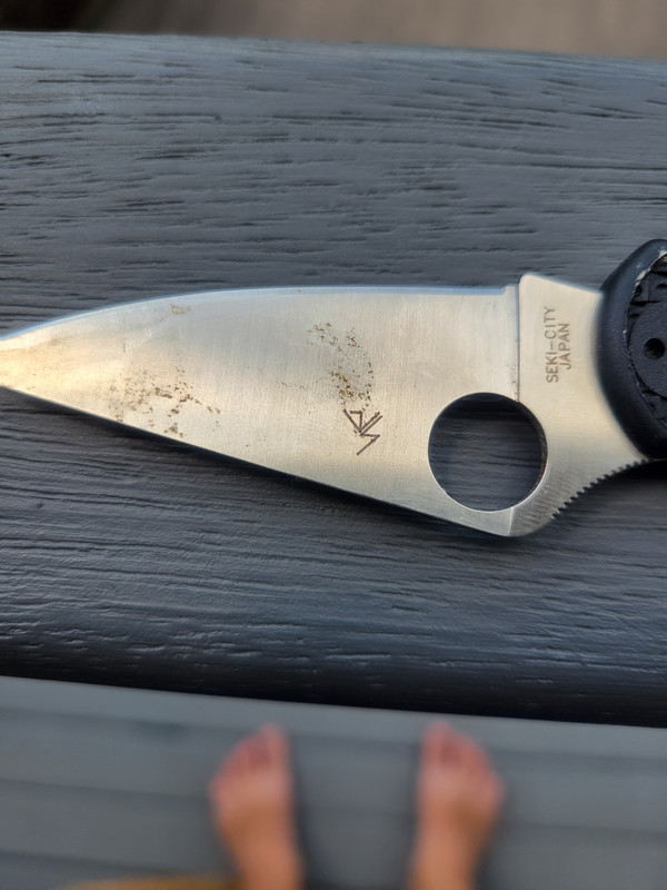

EDIT: I didin't know this forum got so much action or I would have stayed on to answer every question. I also followed the directions of one of the posts to put up pictures. the knife is VG-10 no doubt and the rust is more than surface. I tried spraying it (soaking it0 WITH WD-40 and wrapping it with saran wrap and leaving it for a weak. it didn't help a bit. this knife is less than a year old. my last one made it minimum 10 years, but probably closer to 15 without a spec of rust, although lots of har ww=are and character.
Also. I cant for the life of me find where they responded that they had changed the formula of the VG-10 which is why it might be rusting. i wanna know what the **** is going on

Having seen your pics now, I think you can polish it out with flitz and it will be fine. Not sure what happened but avoid leaving your knife in wet places for a long time and try to wipe off any nasty stuff on the blade like salt, acids, etc.

I added pictures, will you please look again tell me when you think

I'm 20k inland and take my pacific salt anywhre near the bech or salt water. I added pictures, would you please look again and givr a second opinion

I would hit that with some Flitz and it should clean right up.

Going by your first post the knife did not come like that from the factory, right? (I mean you would have noticed that amount of rust for sure right away, wouldn't you?)
Are you 100% certain that you or your wife or anyone else did not cut corrosive stuff at one point and not clean the Delica properly afterwards?
Looks a bit like that, though what speaks against my "theory" is that there is also rust on the ricasso where normally the blade does not come into contact with matter that gets cut.
Again, I don't think that they "changed the composition of VG10" so that it got noticably more rust prone - I have old and newer VG10 Spydies and never noticed such.
Though, as said: I sometimes do have a feeling that "newer" VG10 is run a bit harder, which could lead to a bit less corrosion resistance perhaps. No expert at all though.

Cookie or cake residue and not rust?
Something seems to have gotten on the blade. I'm betting it will wipe off with a wet soapy sponge.

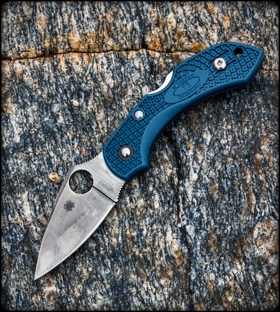

I used to live 10 miles (16 kilometers) inland during my senior year in Hollywood Florida. The salt sea air definitely invaded that far rusting everything including my new bicycle and its cables very quickly. Storms can easily take the salty sea air much further inland. I live in the desert now and find sweat very corrosive and regularly hike in all weathers with K390 a high end particle technology carbon tool steel. It rained on us earlier this week in a canyon we were exploring. I wipe my blade down with mineral oil once a week and wipe it down with a paper towel. Enough stays to prevent corrosion. I do let mine patina first and that doesn’t totally prevent it but does indeed help. In your case I’d just wipe it down with mineral oil and run with it. It is a tool to be used correctly but not babied.
Earlier this week in a southern Arizona canyon. You come out here you better have an edge. The meek ain’t gonna inherit nothing west of Chicago. Tap on the image to enlarge it.
We like to do some light foraging for curiosity and research and cutting plants can be very corrosive so be sure and wipe your blade down immediately after. London Rocket is in season right now. I pitted a brand new high end D2 blade on its first backpacking trip decades ago by slicing salami and not cleaning it immediately.

Because of the clearly defined rust line, it seems to have been something acidic or salty that you cut without cleaning it off afterwards. Maybe you cut a certain kind of acidic fruit?
