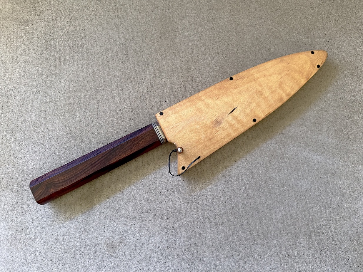

Deadboxhero wrote: ↑Sat Sep 02, 2023 2:07 pmIn the meantime, if you happen to stumble upon a custom knife made by Chad Kelly in Vanax steel, Don't hesitate to buy it. Phenomenal.
This evening's dinner was prepared using a Chad Kelly Vanax knife. The knife is the most beautiful knife I've handled, and it is the best performing kitchen knife that I've ever used. Is the knife awesome because the blade is Vanax? Is the knife awesome because of Chad's artistry? This is a question best left to wiser men than me. But I can tell you, this knife is so good that I'm eager to buy something else in Vanax.

Let's see a pic of that CKelly Vanax kitchen knife!RustyIron wrote: ↑Sun Sep 03, 2023 12:08 amDeadboxhero wrote: ↑Sat Sep 02, 2023 2:07 pmIn the meantime, if you happen to stumble upon a custom knife made by Chad Kelly in Vanax steel, Don't hesitate to buy it. Phenomenal.

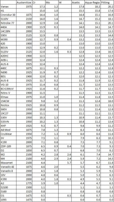

So I had to look up Nitrobe-77 at least in the rankings... where did you get it, is it still available?kirilpetkov wrote: ↑Tue Sep 05, 2023 12:20 amI have used Vanax, but I prefer Nitrobe-77, a very good stainless steel that sharpens extremely easily and is very sharp. I sharpened this knife on a fixed sharpener a long time ago. The last abrasive I think was 1000 diamond and I then went through it on a strop. Yesterday I decided not to put it on a fixed rolling pin at all, just on a strop - 16 micron, 8 micron, 1 micron and finally with 0.125 micron. And that happened in the clip. That's the good thing about this Nitrobe 77 steel that it sharpens extremely easily and sharply.
https://youtu.be/skfSOeuA6bY?si=aq3JRW5DwY69yScd
Here's a quote from Larrin's website:
"Ranking the Steels
To estimate corrosion resistance I used the following equations which were derived as described above, giving a “chromium equivalent” based on chromium, molybdenum, and tungsten in solution:
Acetic acid = Cr + 0.45(Mo + 0.5W)
Aqua-Regia = Cr + 0.79(Mo + 0.5W)
Pitting potential = Cr + 2.6(Mo+0.5W)"
so they are all calculated not measured (just to get all on the same page). And where pitting potential is calculated using a 1% Salt solution, I think that's what Im going to use as the best we have for predicting rust.
This list is pretty impressive. He seems to have done a lot of legwork to generate it. Pretty cool, L.T. (Just in case he reads this - you never know)

I can do that. But I first and to go down to the kitchen and make some good light. I didn't bother polishing it up because this is a real kitchen knife. You're seeing the way she is in her native environment.
The handle is desert ironwood, titanium, and G10. The saya is maple, nickel, and copper. She's as beautiful to use as she is to look at.

RustyIron wrote: ↑Wed Sep 06, 2023 7:10 pm
So beautiful. I love ironwood and the design is eye catching. Very very nice. Im glad I asked.

I haven't seen this written out on the web, so I am writing it here: A comparison of the current super corrosion resistant knife steels or rust proof* knife steels in the market today**.
1. Vanax 2. H1 3. LC200N 4. Magnacut (in order of corrosion resistance).
1.Vanax 2. Magnacut 3. LC200N 4. H1 (in order of edge retention).
1.H1 2.LC200N 3.Magnacut 4. Vanax (in order of toughness).
