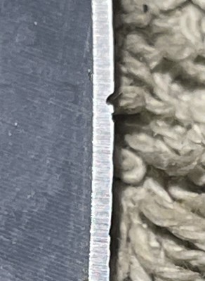

Hello all,
I've been using this M398 Mule for a few months now and the edge retention is awesome but the blade chips very easily. I have been cutting every cardboard box I can get my hands on with it and it will cut them forever without dulling but was looking closely at the blade one day and realized it has bad chips in it. I would not say that I have done anything abusive that would lead to chipping like this so I was very surprised when I noticed them. I have not sharpened the blade but I have stropped it once to restore the razor sharpness. I did not notice any chipping at that time.
Best regards,
Kenny
Best Regards,
Kenny
Manix 2 CPM S30V G-10, M398 Mule :bug-red-white
standy99
Posts: 2357
Re: M398 Mule Blade Chips
Post by standy99 »
Looks more like a burr rolled at the front…wouldn’t call them chips, and with a factory edge that hasn’t been sharpened.
A few months without sharpening I think your doing good, as that’s not that bad…

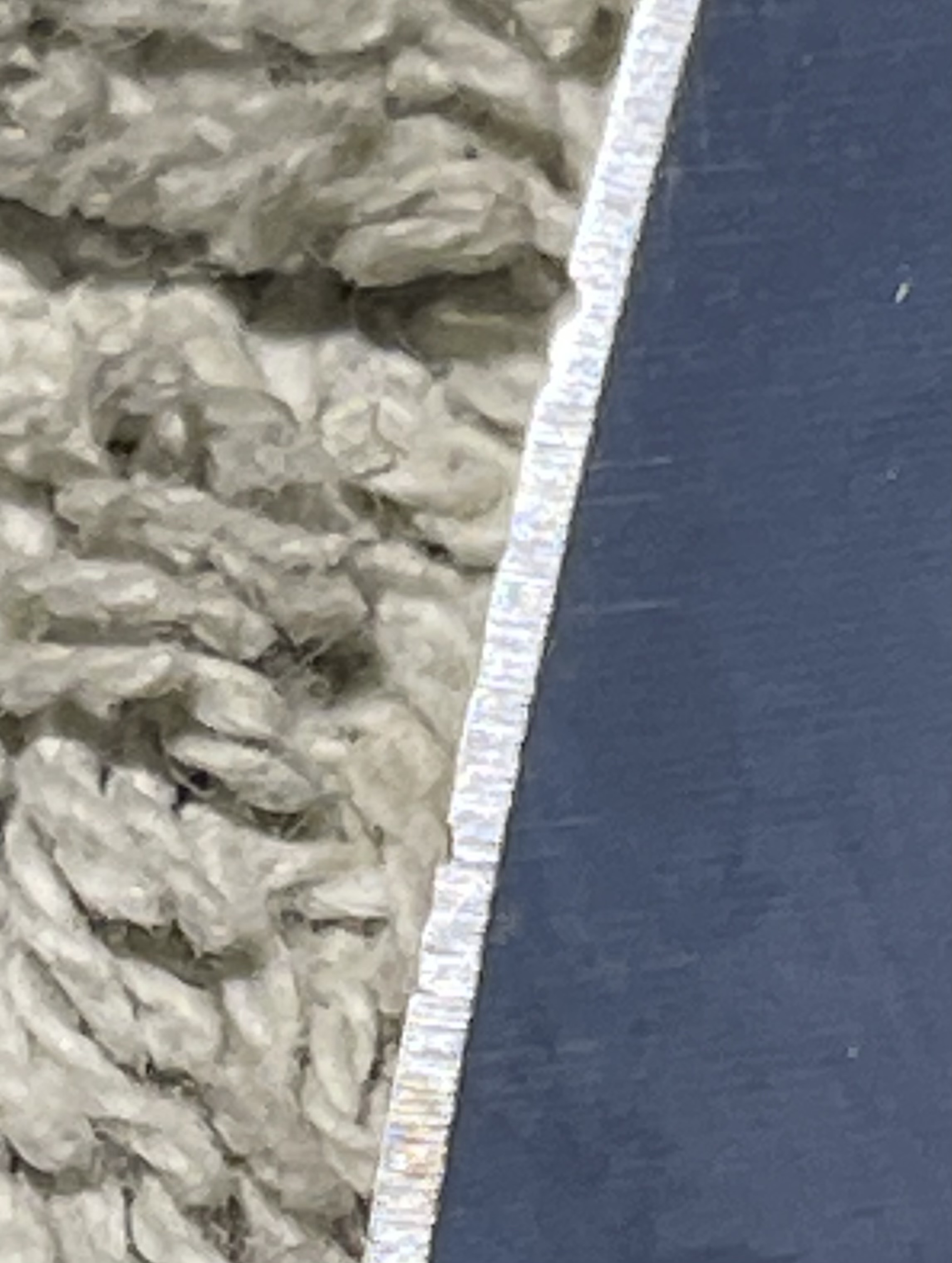

No... not rolled at all... they're all chips. Here are more pictures from both sides. Some of the chips do reflect light but it is very hard to take a picture of them without reflections.
Post by Mage7 »
Cardboard can hide a lot of nasty little surprises, so I wouldn't be surprised if you might have hit some inclusions that contaminated the pulp.
Can you reprofile it? I would probably take it to 20 degrees per side, or at least micro bevel it. M398 did come in pretty low in toughness on knifesteelnerds blog
Post by Traditional.Sharpening »
akennyd wrote:
Thu Aug 24, 2023 6:05 am
Hello all,
Best regards,
Kenny
A few points...
Firstly, I'd want to sharpen the blade at least a half dozen times before jumping to any conclusions about the steel. This is needed to try to eliminate factory processing as a potential detriment to the steel.
Secondly, this type of behavior is entirely within the realm of expected considering the carbide volume of the steel. It's also possible that there is something going on at a microscopic level of the steel/heat treat that is causing further embrittlement.
Too early to say anything definitely until you resharpen and see if the behavior changes. Get a good coarse stone and grind away all the chips and reset the edge, I'd not go anything high polish on that blade personally as there's little benefit there.
One other suggestion I'd make would be to LOWER the edge angle if possible and RAISE the apex angle with a micro bevel to at least 20 DPS. This will not entirely eliminate chipping but may minimize it through less force required in cutting.
