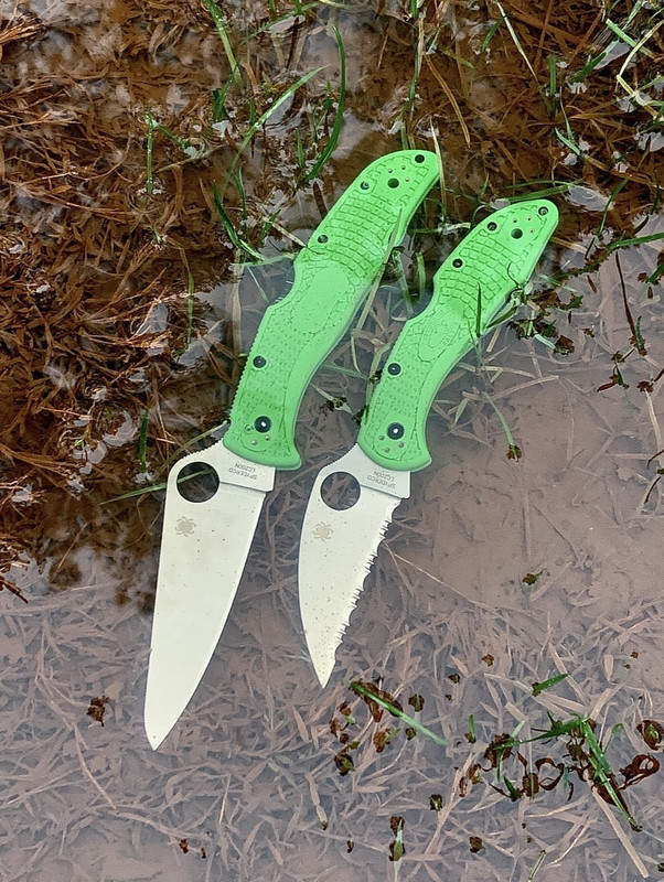

I assume we´re talking folders? If so:
Pacific Salt SE (in my case the "1" and in H1) - or the Salt 2 SE if I bring a fixed blade too.
- The "Salt" aspect is not important at all to me, even a tool steel would be fine. This despite my knives certainly get (and stay for a while) wet on most backpacking trips. Be it from rain, snow, mud or stuff I cut or just moisture in pocket or pack. I still don´t have rust problems though or would not mind a few spots on a blade
- Used to carry my folders rfp when backpacking, but lost an Endura while doing so (longer knives can get pushed out of the pocket when doing high steps). Now pretty much all of my PACKS do have a front pocket or I attach a small pouch to the hip belt where I keep the folder. When not wearing the pack: RFP in camp, IWB on the move (again, outdoors and doing a lot of high steps. Don´t like iwb generally)
- SD is not on my mind when backpacking. Still longer blade (if I just carry folder!): More versatile, stays sharp longer, better at food prep...
- Yes, I do make fires for cooking and warming, so wood is in my mind. I found SE to be perfectly suited for that kind of wood cutting! Whittles great due to the chisel grind (as long as one just does rough pointy sticks or whatever) and makes amazingly fine feathersticks
- Uses?_: Food prep, starting fires, removing ticks, repairing stuff, cutting branches for a "matress" or shelters, emergency use (for makeshift splints or crutches), scraping resin from palms or snow from ski climbing skins, and certainly more not on my mind right now...

Added to my post above:
SE over PE, on a folder!
- Just stays sharp a lot longer, and will still decently separate matter when actually / technically NOT really sharp anymore...
- Even the kind of batoning I do with folders (smaller branches, just for making kindling) is no problem for the "teeth".

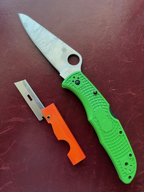

For longer trips a razor blade will cut food packages, lines, and moleskin with minimal weight penalty. For overnight trips where I'm gonna do food prep I like the Pacific Salt.
I agree with Mushroom that a knife is not strictly needed for modern backpacking. Especially for the Sierras since open fires aren't permitted and all your food needs to fit in a bear canister. That said, if I were to recommend a Spyderco to take backpacking its the Dragonfly 2 which can do anything I'd need and more without adding much weight or bulk.
