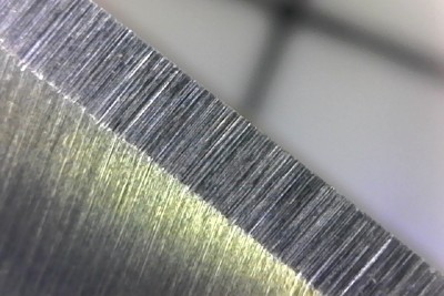

Re: New Knife Sharpening?
Dkeller717 wrote: ↑Sat Apr 16, 2022 7:15 amIs it best to always sharpen a new knife that was just purchased to get optimal blade performance?
No, it's is not always best.
Do you want to do ocular surgery? Maybe you'll want to touch up your new blade.
Do you want to manscape? Maybe you'll want to touch up your new blade.
Do you want to do regular pocket-knife stuff? You're in luck because Spyderco has been figuring out what most people want for quite a while, and they've done a pretty good job at providing that. With every new knife I get, as soon as I take it out of the box, I put it under the microscope and take some pictures.
I just happen to have a new Spyderco right here, and I'll shoot a couple pics. See the attached images. They're of the same spot on each side of the blade. As far as I'm concerned, the edge looks pretty darned good. All my recent Spyderco's have looked similar.
Do I sharpen knives right away? Generally not. I like to use them a little so I can experience what the manufacturer intended. And then I put my own edge on the knife. It might be two days or two weeks, but pretty soon I'll want to see what I can do with the edge.
