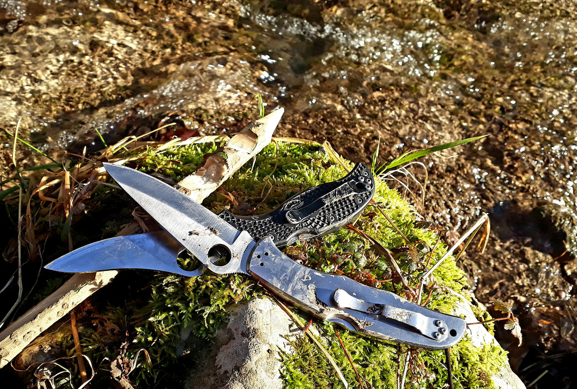

My stainless steel Endura has abruptly developed a really gritty action.
Guess some dirt or sand must have gotten between scales and liners (EDIT: Meant WASHERS, not liners) or washers and blade in the pivot area.
In the 180 degree half circle the blade does when opening the knife, the "grittiness" starts at about 90 degrees, there actually are noticeable resistances to overcome at three points (a bit like with a half stop) and the action is generally gritty till the blade is almost opened.
The knife is still usable, though actually clearly harder to open and close one handed, and with a terrible "crunchy" feel.
Now the SS Endura has no screws at all (except for the clip), so I can´t disassemble it and can´t adjust anything.
- I tried to flush it with hot water and dishwashing liquid, I opened and closed it multiple times while trying to tilt the blade a bit to the left or right, also with the lockbar always kept depressed, I worked a sheet of paper between blade and scales at the pivot and moved it up and down there (the paper) hoping to "clean" the area...nothing worked.
- Oiling the pivot makes the issue a bit better, but just indirectly (does not actually remove the dirt or whatever is in there)
- Only thing left I can think of is compressed air (actually just ordered a can, so far I never needed compressed air for anything)
Any ideas? I´d really appreciate your input!

Are you holding the lock bar down when you flush the pivot area? I find that necessary to flush lock backs fully. I also sometimes have to flood the pivot with mineral oil to help float out the grit. It is messy and can take time to allow the oil to lift a carry the grit away.
Also, have you used a bright light and your loupe to inspect the tang of the blade where the lock bar rides? The curved portion. You may find machining marks that are the actual cause of the grittiness. Those are much more difficult to deal with, I'm sorry to say.

Try some PB blaster penetration oil , with blade 1/2-2/3 open lock bar open and blast it clean

Pack the pivot area full of toothpaste, open and close a few dozen times, wash with soap and hot water scrubbing with a toothbrush all around the pivot area with the blade both opened and closed.
If it's better but not 100%, repeat the process. Some people prefer to use an actual polishing compound but I've found them harder to remove completely. I do this on my SS and pinned FRN models when they get grit or sand stuck in the action.

I find holding the lock bar down helps a lot. I also put a light layer of vaseline on the blade in the pivot to help decrease drag where the lock bar glides

back when I carried the pinned Pacific Salt 1 this was my method:
toss the whole knife in a bowl of really hot soapy water.
flush it out with the lock release depressed.
repeat both steps again.
give the pivot a final rinse with the lock release depressed using a high pressure sprayer (garden hose with your thumb covering most of it can do the trick. I had access to a commercial dish washer back then with a high pressure sprayer).
finally, give it some lube.

I was going to suggest something like Birchwood Casey Gun Scrubber or disc brake cleaner spray, followed by some kind of lubricant. Really, there are a thousand spray cleaner/lubricant products that will be suitable. Just hose it out until all the contaminants are washed out.

It depends on what you have in your country, but here I would try a penetrating oil called PB Blaster, it's pretty well known for being able to creep it's way into tight places and lubricate things and it might help to get out whatever crud is making the action gritty.

I think the oil has to be thick enough to hold the particles in suspension, at least long enough to float them out of the action. Super penetrating oils won't do that, but they do help removing other contaminates.

It’s the PSI from the spray when used with the spray tube, brake cleaner will blow it out also
But must be followed up with a oil to lubricant ( example drop or two of 3:1 oil )

yeah, i hold the lock at down and work the blade back and forth quickly while water is running through the pivot area. i do that from the back and flip it over and flush it through the handle as well. i've never disassembled my pac salt and that's always worked to get gritty sand and shells out of the pivot.

Thanks much for your inputs, guys!Holland wrote: I find holding the lock bar down ...
- Yes, whenever I have to flush the pivot area of a lockback (which is almost never the case though) I do this with both the lock depresses and not depressed
- I did inspect the area with both my 10x and my 20x loupe and a strong light indeed. Nothing to see there, and I think machining marks can be ruled out, since the issue occured abruptly. Using and closing the knife, all fine - put it in pocket - next time opening it - gritty...
- @ Holland: I´ll try the Vaseline, just out of interest - never would have needed this so far on any backlock, but probably it is still improving things
