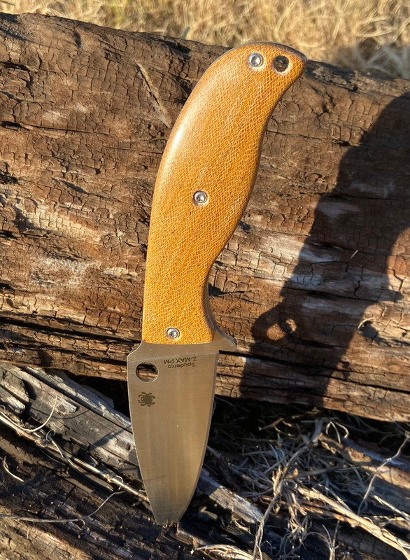

[img] https://i.postimg.cc/HLPzJ3Q4/FB2-E0-CC ... 0-CFAA.jpg[/img Mine just came in from Halpern . Very close to Manix2 G10 DLT . Lighting not the best . Going to talk to guy in town who makes leather sheaths this week after I assemble the Mule once it arrives .

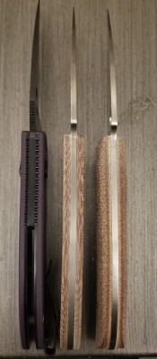

thanks! can you post pictures of those on the mule from multiple angles when you get it? i'm mostly curious about the spine view, i guess, to see how thick they are and get a sense of how they'd feel.
Re: scales and sheaths
I have some I will throw on one of my mules and get pics up unless someone beats me to it. I have both Type 4 and 5 from Halpern.

Got home from work and forgot this.
Right to left: Manix 2, Type 5, Type 4

that is very helpful. thank you!
No problem, sorry I didn't get that last night. I will get a few more again when I get home... lol. I remembered "spine view" and did not take any other angle shots before I left for work.
They are very much like the micarta on the new PM2 but have slightly more rounded off edges on them I feel. My hand likes the crucarta PM2 very much, but it does not like the Type 5 on the mule as much. I think if they were thicker (maybe some spacer material?) I would like them more. They are not as wide as the Manix 2 and I really like it.
I much prefer the Type 4 style right now. I think I should experiment with some spacer material on the Type 5 since talking about it.

More pics of Type 4 and 5 scales, and the G10 ones too. I did not put the middle pin in for the pics.
Better view of the flat vs curved

thank you! how do they feel in hand? are the flat scales uncomfortable? how is the texturing on the rounded scales? micarta vs. g10? thanks again for sharing!
@Ladybug93 and anyone else interested!
I hope my thoughts below help. I'm still learning these Mules myself.
Micarta vs G10: I prefer the micarta to the G10. If G10 were all I could get I wouldn't be mad in the least.
Flat Micarta: Texture-wise and feel are great, very much like the feel of the crucarta pm2 scales. Velvety, warm, soft and fuzzy but yet grippy? I haven't figured out how to describe that feel.
Profiled Micarta: Feel is great, that same feel as above. But it also has a texture added to it similar the G10 scale.
G10: They are just kinda hard and cold feeling, but the texture on them is nice.
Flat vs Profiled: I prefer the profiled for now, it could change see below.
I really wanted to like the flat style in micarta. I felt that it would make a great pack knife or kitchen knife with the flats. I bought them first thinking all this and in my head going yea!!! In the end I wish they were a bit wider than they are. I had hotspot issues with them pretty quick. If they were a bit wider, maybe 1/16" to 1/8" I think it would fix those issues for me, someone else may feel differently. The edges are rounded a decent amount, that didn't seem to be the problem.
This all has me thinking about doing a more permanent attachment with liners and those flat micarta scales somehow. Because they really feel good otherwise. Studying up on all that....
The profiled micarta however feel great. Like the G10, that are also profiled, I don't get hotspot issues with them so far. They seem to fit my hand just right.
