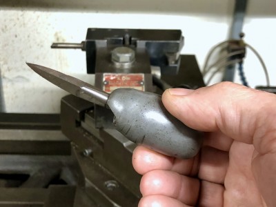

I've got a couple homemade Burr Knives. They're handheld tools used mostly for chamfering the corner off a rotating part that I just finished boring in the lathe. While you can buy tools for this purpose, I've never seen one I liked. A homemade burr knife will be made out of some kind of broken or unsalvageable cutting tool. Grind it to shape, put a handle on it, et voilà! The one in the picture is ground to three corners, so it's about 120 degrees per cutting edge. "Shaving sharp" is not the goal. A bit of pressure is used, and as you move the burr knife around, you'll feel when you get the right angle. It's used on steel, bronze, aluminum, plastic... it doesn't matter. Usually no damage occurs tot he tool, but eventually the surfaces wear and need to be touched up.

I've got a couple homemade Burr Knives. ..
Hey Rusty, I learned early in my time as a young apprentice the value of a decent debarring tool.
I still have a three corner “scrapper” I made around my 2nd year. It’s a hollow ground (though many times sharpened now, on a flat stone) three corner file. I still use it today on my little lathe at Mum and Dad’s place (otherwise I’d post a pic).
I must have made it around 1977 and marvel at my skill and eyesight at the time. Ah, hahaha! And, I still haven’t found anything that holds a candle to it.
