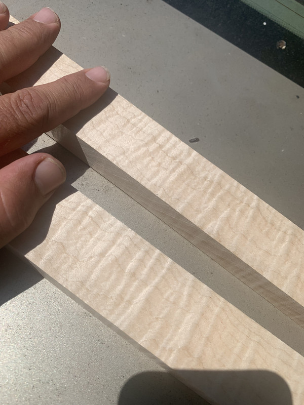

I found some good maple to try to stabilize for mule scales. Should I just do donate money to charity and whack my thumb with a hammer then buy stabilized wood and be ahead of the game or try it at home?
What I know…
Very little
you need a vacuum or a means of hand pumping the vacuum, a pickle jar or a fancy vacuum chamber, vacuum lines and fittings, wood stabilizer, a means of heating the soaked wood to cure the resin and too much time on your hands. Does this sound right?
I could also send the wood to someone to get it done.
Who does their own that can talk sense into me?

I lucked out finding about 6 feet worth of material or 6 handles worth with figure resembling quilted maple for the cost of regular maple only paying $20 so no huge investment at this point. I also have a sentimental timber of about 70 lbs of Mexican royal ebony aka catalox that has a good story to it that I was thinking on making into a matched pair of rifle stocks with some extra for things like knife scales but that needs no stabilizing but my true love is desert ironwood. I think I should buy some knife kits to practice on since mules are pricey and can be difficult to source before I reach beyond my skills and have a sub par handle. If I make the scale material ready, then I can have more talented people do the hard part :D I think I will enjoy making handles but the time to get good is not there yet. I like deep reds and blues for knife handles and maybe green for my Irish heritage. I find natural maple just too light for my tastes. I should probably just send it to someone to stabilize before I ruin it lol :eek:
