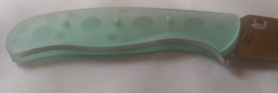

I just got done with a several hour print of mule scales. I used a Anycubic Photon Zero sla resin 3d printer. They're printed translucent blue. I still need to clean off the supports and drill holes bigger.

I got some weird patterns on the back sides of the scales. I'm not sure if its the slicer or the printer causing it. They were printed vertical so I would expect perpendicular/horizontal lines not at some random angle. The same model was used for both sides just mirrored using the slicer(Chitubox). They will be sanded down on the back sides so it shouldn't be an issue. The fronts look like wood grain, almost like a fdm printer made it lying flat. The model was smooth in Fusion so I might try a different slicer. They should be a lot clearer when I'm done.

Very nice, where did you find the STL, or did you draw it up? I was surprised I didn't see a model for mule scales already on Thingiverse, I'd like to turn some out on my Prusa for the next mules that I (hopefully) pick up.

I made it myself in Fusion. Heres the thread where you can find them.

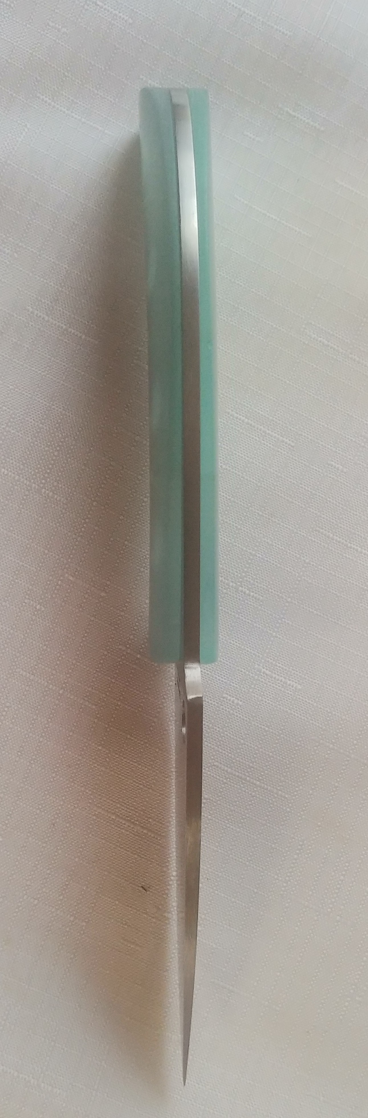

I did some sanding last night. I also printed small centering pins to help test fit until I figure out mounting. I'm not sure if I should use another material or just print some 3/16 pin with the same resin.

Josh, can you print the pins as part of the scale, so that it's one solid piece through, and you don't have to drill into the outside?
You could put small receiver holes in the opposite scale to catch the pins, which would increase stability. And then you could make half the pins come from one side, and half from the other. You could even make a much larger number of pins than standard.
Heck, now I'm picturing a set of scales with built in 'pins' that snap onto the mule like a pair of legos. :)

That's a great idea! They would look awesome with no hardware. How should mount the ones I already have? They have a few flaws so I don't want this set permanent. One side has a line of tiny bubbles down the center. I think that one wasn't perfectly vertical when printing.
Drill them for Gulso bolts. You're going to want to take them off and put on the next iteration, and the next, and the next, and you'll be unhappy with yourself if you permanently attach your first set to your Mule. Ask me how I know...

I need to order some where do you get them?
It's the only mule I have, I had no choice but to rip off the white g10 scales that were on it. Luckily I had an idea it might happen so I used a silicone glue instead of epoxy. They didn't get damaged so I'll use them again some day. For now I'm going to keep 3d printing them. I'm trying to figure out textures or some kind of design to try on a few. I have a Native 5 LW now and plan to model the scales next week.
