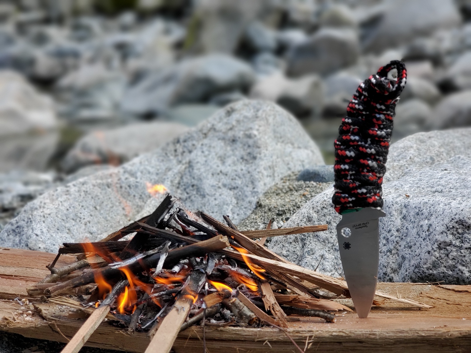

I finally got a chance to get out and give my SPY27 Mule its first good usage. I gave it a quick wrap with some tarp twine I had but plan on putting a proper handle on it soon.
The factory edge came pretty sharp out of the box but it is definitely a very striated edge. If it is anything like my Para3 in SPY27 then it will definitely perform better with a finer edge on it.
It didn't get any seriously abusive work done with it, but I shaved a bunch of feathersticks, battoned a bit of wood, and chopped a few chunks at a pretty obtuse angle. I was mostly working with cedar but also some pretty sappy Douglas Fir Fatwood that was pretty hard.
Overall it did good, no discernable rolls or chips. The ergo's are ok but the handle is a bit small for my hands. I much prefer my Military sized handle but once I put some wood or stone scales on it I am sure it will be better.
I want to use it a few more times for similar tasks so I can start to get an idea of its overall edge holding ability for bushcraft type tasks.

Got out for another day with the MT28.
Still didn't make time to dig out any proper paracord or put a proper handle on it but I did wrap some 1/4 nylon rope around it and it really filled the handle out to where it filled my hand nicely and felt way more natural using it.
I spent a ton of time just slicing and batoning wood to really put it to the test. I was burning a bit of red cedar which is pretty soft but also some nice hard maple which took quite a bit of work to break down.
I even used the spine to throw the sparks off the ferro rod. Sparking a ferro rod with a knife spine is an interesting test of blade steel. Softer blades like an old buck in 440 really feel soft and after a few strikes you can really see the 90 edge rolling over or small divots appearing.
On the SPY27 I could not even tell where I had struck it. It will take a few more trials to really tell how it holds up but so far it looks good. It also felt really "crisp" when striking.
I made sure to beat through quite a few big sticks of maple that were at least 2 inches plus. I probably broke down enough kindling for at least 5 or 6 fire starts and did a lot of work I would normally use my axe for.
Overall this was a pretty good torture test as far as bushcraft and fire starting duties goes and I am happy to say the SPY27 help up really well.

Another night and another fire with the Spy27 Mule. But, this time it is sporting its new Ironwood scales.
Tonight's work was pretty easy with just some quick feathersticks out of dry cedar. But, I did continue using the spine for striking my ferro rod, although, it only took two strikes to catch. That said, there is still no discernable marks from striking the ferro rod.
I must say too, that this little knife is really growing on me. Especially with its new handle that makes it much more comfortable to use. So far it has been out for 4 trips and helped start about 10 fires, all on the factory edge. I can feel it working a bit harder on hard wood like maple but on tonight's cedar it is still plenty sharp to do the job.

Re: The Canadian Bushcraft Test
Nominating these ^ for Most Stunning Photos of a Mule in Action...wow, what a wilderness.
Am enjoying your real-world field tests here. Good work, man.
The angle of your second shot had me contemplating what a Mule would look like with a false edge swedge on the blade...
