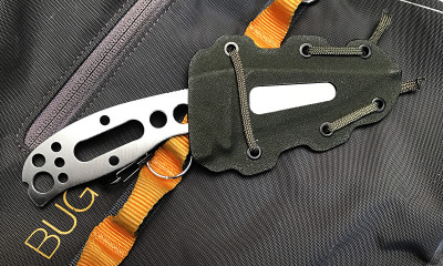

Skeletonized Mule for Backpacking
Here’s a mule modified for lightweight backpacking. The index finger radius was reduced for comfort, the handle slimmed, the end bobbed & a middle oval ground. All edges heavily chamfered, then the handle was stonewashed (you can just see the two-tone difference between the matte handle and as-original blade), and the thumb area jimped. The skeletonized knife has a pleasant, almost buttery hand-feel although the thumb jimping is sharp; could be cord wrapped in the field for heavy use. However, if a trip goes as planned, knife use is minimal, so a ‘bare bones’ knife should work fine for 90% of backpacking use.
Weight was reduced from 2.8 to 2.4 oz, a 15% reduction. May not sound like much, but a 15% lowered weight sells ultralight backpacking gear! What I’m most happy about is the blade-for-weight ratio. It is in the same range as the lightweight Salts and the Bugout…except…it has a full tang and can therefore be used much harder!
Next up: Find a kydexer who can make me a lightweight sheath…suggestions?

Easier to see the mods with a comparison:

Nice work. I am a big fan of the jimping. Super nice seeing a %15 weight reduction. I know light weight trippers will take off zipper pulls and just pinch grip the closure, saves weight. I like when the knife hobby makes outdoor pursuits more fulfilling. Cutting fish with the Waterway makes me smile. You are certainly checking the "create," box in the Mule Team banner.

Kydex is pretty easy to work. Buy a couple of sheets and try it. It's a lot easier than what you did to the knife.

Looks great! I love the way the jimping turned out. Am I seeing correctly that you beveled the sides of the jimping?
As for Kydex..super easy for you. I seriously suggest you should do it yourself and you'll be happy that you will forever have the ability to make yourself a sheath any time, for any knife...in about an hour.
Get a sheet of Kydex or Holstex (I think it's only about $5.00 for 12x12) and get 1 piece of molding foam (11.5" x 11.5" is about $13.00). You can order grommets too but if you don't want to get a grommet setting tool (and don't already have one) you can just drill holes and use sex-bolt type fasteners that are about $1 a piece. In total you can make your own for as little as $22 plus shipping. But if you can spend the extra $10-$15 get a grommet setting tool and some grommets. All of this is available at USA Knifemaker.com and a bunch of other knife supply sources.

ArnAnders89 wrote:
Mon Jun 07, 2021 2:19 pm
How did you do those tube rivets on the knife in the picture of your first sheath?
Thanks for the info! Pure gold man.
:D That was where it all started for me. That was the first knife handle I ever made. I've been stuck in my garage ever since :p .
Those are just large copper tubes with fairly thick walls. I should have flared those or at least rounded them with sandpaper :eek: :o . I used one large corby to hold the scales against the tang and the 2 copper tubes are epoxied into place to provide lateral support.
Eventually I decided there were things about the way I built that first handle that bothered me so I cut those scales off and rebuilt it. This is how it looks today.
Those are also just lanyard tubes. 1/4" stainless tubing this time.

That’s sweet man! Exactly what I want to do with my first mule is those stainless tube rivets! (picked up the s45vn last drop) I’ve been trying to think of a way to flare them without an arbor press, any ideas there would be greatly appreciated!
Oh and you got me inspired to build my own kydex press! I’ve been on the fence about it but have wanted to for a while now, I was also looking into how to make leather sheaths and that wet molded leather looks pretty nice I’m going to study up on that to!
