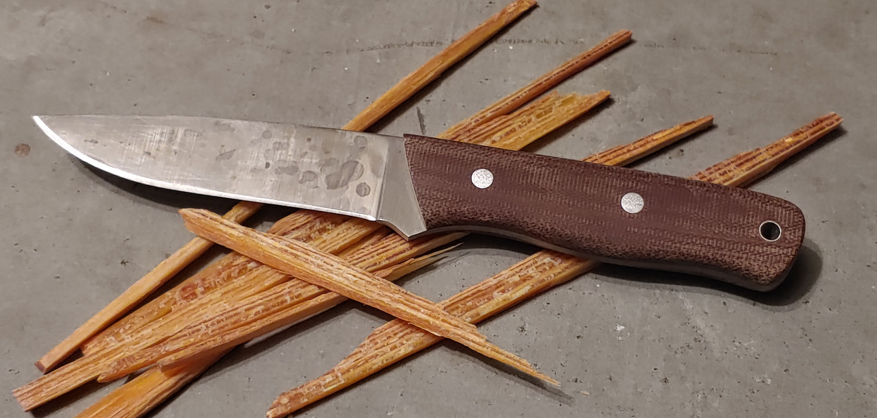

Not just Bark River but lots of small makers. Here's one I got in A2 like I was talking about. Kydex sheath, sculpted micarta scales, all for under $80. When I compare something like that to a $200 Temp 2 its tough to justify the Spyderco.Pancake wrote: ↑Mon Nov 23, 2020 11:45 amHey David
