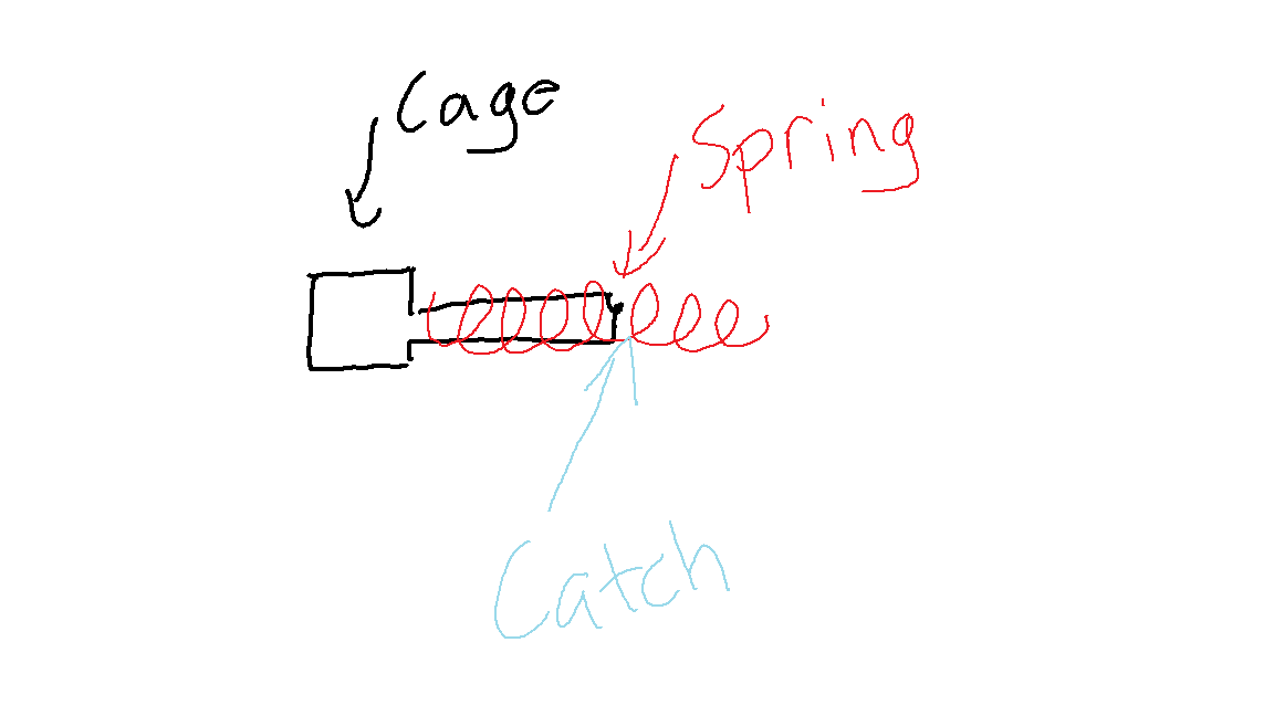

Yours is most likely caused by the rod that the spring rides on, which is molded into the cage. The manix is one of my favorite models and I've extensively looked into the maladies and variances that can happen with them.
In examples that have the "click" I have realized that it is often related to the cage/spring interface. As the lock is forced back, the spring must slide onto the rod as it compresses. As we all know, as you compress a spring it will try and go sideways unless kept in line by force.
Anyway, when the spring gets pressure applied to it and it starts to compress, one of the "loops" of the spring gets caught on the very end of the plastic rod and causes a little click, and most of the time a "catch" sensation that you can feel as well. Once past that little catch it will generally ride smoothly because enough of the spring is now on the rod that it is forced into perfect alignment.
Many times there is a little bit of plastic flashing, or a "pip" of plastic left over on the very tip of the rod from the molding process. This can exacerbate the issue. I've had success in filing the tip of the rod smooth and getting rid of the catch.
Anyway, hope that makes sense.
Thats good info. Is it perhaps something that will go away over time on it's own?
