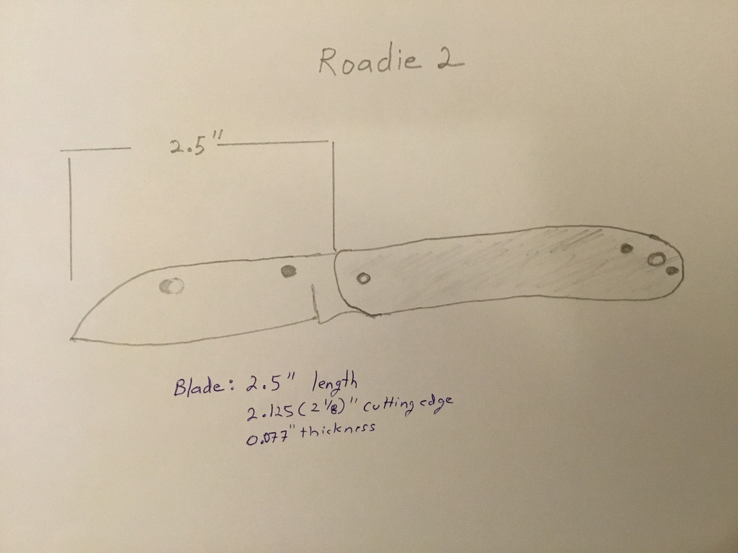

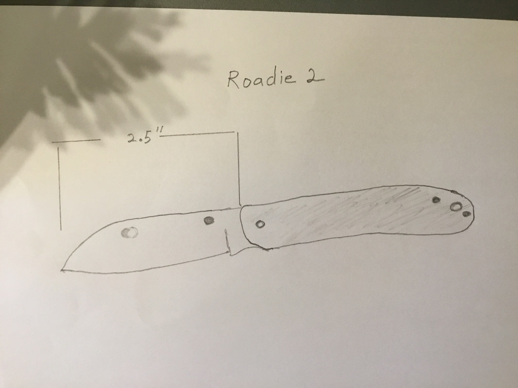

Hi Sal, I was not sure how to contact Pete so I thought I would put my idea here. I’m sorry fir the terrible drawing but I hope it carries the idea well enough.
I also thought it would give the others a chance to weigh in. Jazz has a design also.
Anyway, this is it.
I wanted a modified sheep foot/wharncliffe blade with graceful lines. I have not worked out the blade width, only to say proportional increase over the current Roadie based on increased length. The current a Roadie is so easy to pocket, like a pencil stub, and I was trying to keep that ease in mind when drawing this.
It’s ok to laugh. My skin is thick.

I quite like that. I like the smaller spydie holes (spydie nicks?) and the less pronounced hump at the tip. Looks like you shortened the choil a bit to squeeze a little more useable blade in. Now if this was made with nice thin 2mm stock I wouldn't hesitate to pick a few up!

Doc Dan
Posts: 16180
Re: Sal—design for Roadie 2
Post by Doc Dan »
sal wrote:
Wed Mar 25, 2020 3:09 pm
Hi Doc,
I'd like more input. You have only added a small amount to the length?
The original Roadie was designed to meet the European requirement for airline travel. We thought it would make it to the US, but never did. Are you asking for a slightly larger version, or is there more input you'd like to share, or input I'm not seeing?
Hi Sal,
Yes, I want a slightly larger version, one that can more easily cut apples. hahaha! The current blade is too short for that. What I want is still slim like the original, but a slightly longer and broader blade, but not as broad as knives like the Cat or Squeak, by any means. I like how the current model is so trim, about like a #2 pencil. I was also trying to smooth out the transition to the hump and then give it a bit of a point, while still keeping to a modified sheepfoot like the original. The slightly broader blade I would envision to be just a little thinner in stock and thinner behind the edge. I did not include a swedge, but it could have a shallow one if desired, but not necessary. The current Roadie has a 2.09” blade. I prefer 2.65 inches in blade length but I chose 2.5 inches because of so many local laws limiting pocket knife blade length and I did not want the overall knife size to get too large. Trim and slim like the original, but slightly longer in blade and blade width. Does this make sense?

Is that a Myrtle-esque recurve on the Doc’s sketch, or just a slight belly? I’m not sure how a belly on a wharncliffe would work.
As an alternative I wonder how a (very) asymmetric spear point might function.
Doc Dan
Posts: 16180
Post by Doc Dan »
Hi Doc,
Here are some dimensions.

ChrisinHove wrote:
Thu Mar 26, 2020 1:26 am
No, just crappy drawing. :D
It has a slight belly like the current Roadie.
