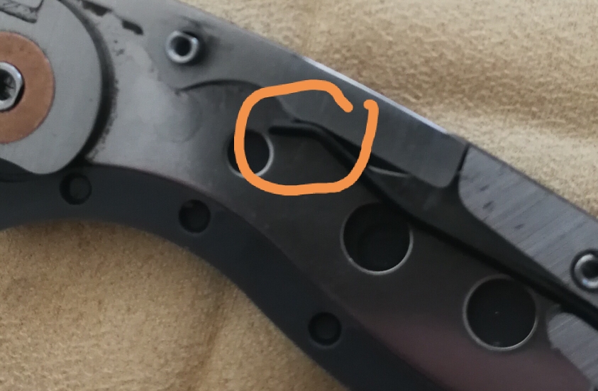

Jeremy, concerning making the backlock less hard to operate I wanted to add:
On youtube, there is a video by Nick Shabbaz "How to disassemble and maintain the Spyderco FRN Chaparral Pocketknife".
There you can see the spring of the backlock (looks like an almost black piece of wire). If one moves that spring just a bit more to the front (so that it does not extend fully to the end of the slot it´s rear end is located in), the lock will be easier to disengage.
Again a topic that´s a little harder for me to explain in English. And once more: Though it is not hard to dis - and reassemble the Chap if one has some experience with knives or is at least technically skilled, I don´t recommend it to a person new to knives.
But maybe you know some skilled adult who could watch the video and decide if he or she is safely up to the task.

David, I guess you don´t have some pics of the mod for Jeremy to look at? I advised him in my post above to a vid of Nick Shabbaz where he can at least see the spring and figure, what to do, but not the relocation of the spring itself...David R wrote: ↑Mon Mar 18, 2019 1:36 pmSeconding this. Found this out when mine was disassembled and thought "what would happen if..." It works great for me this way.Wartstein wrote: ↑Sun Mar 17, 2019 10:37 pmConcerning the stiff backlock: There is quite an easy fix for that, but it requires to disassemble the knife.. What you'd have to do is to move the spring of the lock just a bit more to the front.

Re: My First Spyderco Knife!
That worked Great, moved the spring forward So the angle on the spring aligned with the angle on the backlock. About 3mm made a huge difference. :)

Somebody beat me to it. If that doesn't make it clear I can try to take some pics tonight.Wartstein wrote: ↑Tue Mar 19, 2019 12:15 amDavid, I guess you don´t have some pics of the mod for Jeremy to look at? I advised him in my post above to a vid of Nick Shabbaz where he can at least see the spring and figure, what to do, but not the relocation of the spring itself...David R wrote: ↑Mon Mar 18, 2019 1:36 pmSeconding this. Found this out when mine was disassembled and thought "what would happen if..." It works great for me this way.Wartstein wrote: ↑Sun Mar 17, 2019 10:37 pmConcerning the stiff backlock: There is quite an easy fix for that, but it requires to disassemble the knife.. What you'd have to do is to move the spring of the lock just a bit more to the front.

Thanks ! I was just asking forJS_knifenerd since I felt I could not explain the mod properly to him. I am sure if he should decide to try the mod and the pics already uploaded here are not clear enough, he knows now where to ask... :)David R wrote: ↑Tue Mar 19, 2019 9:06 amSomebody beat me to it. If that doesn't make it clear I can try to take some pics tonight.Wartstein wrote: ↑Tue Mar 19, 2019 12:15 amDavid, I guess you don´t have some pics of the mod for Jeremy to look at? I advised him in my post above to a vid of Nick Shabbaz where he can at least see the spring and figure, what to do, but not the relocation of the spring itself...David R wrote: ↑Mon Mar 18, 2019 1:36 pmSeconding this. Found this out when mine was disassembled and thought "what would happen if..." It works great for me this way.Wartstein wrote: ↑Sun Mar 17, 2019 10:37 pmConcerning the stiff backlock: There is quite an easy fix for that, but it requires to disassemble the knife.. What you'd have to do is to move the spring of the lock just a bit more to the front.

Maybe I'll do the relocation of the spring quickly on my own Chap, just to see how much difference that would make. But, as said, generally I like the lock as it is.
