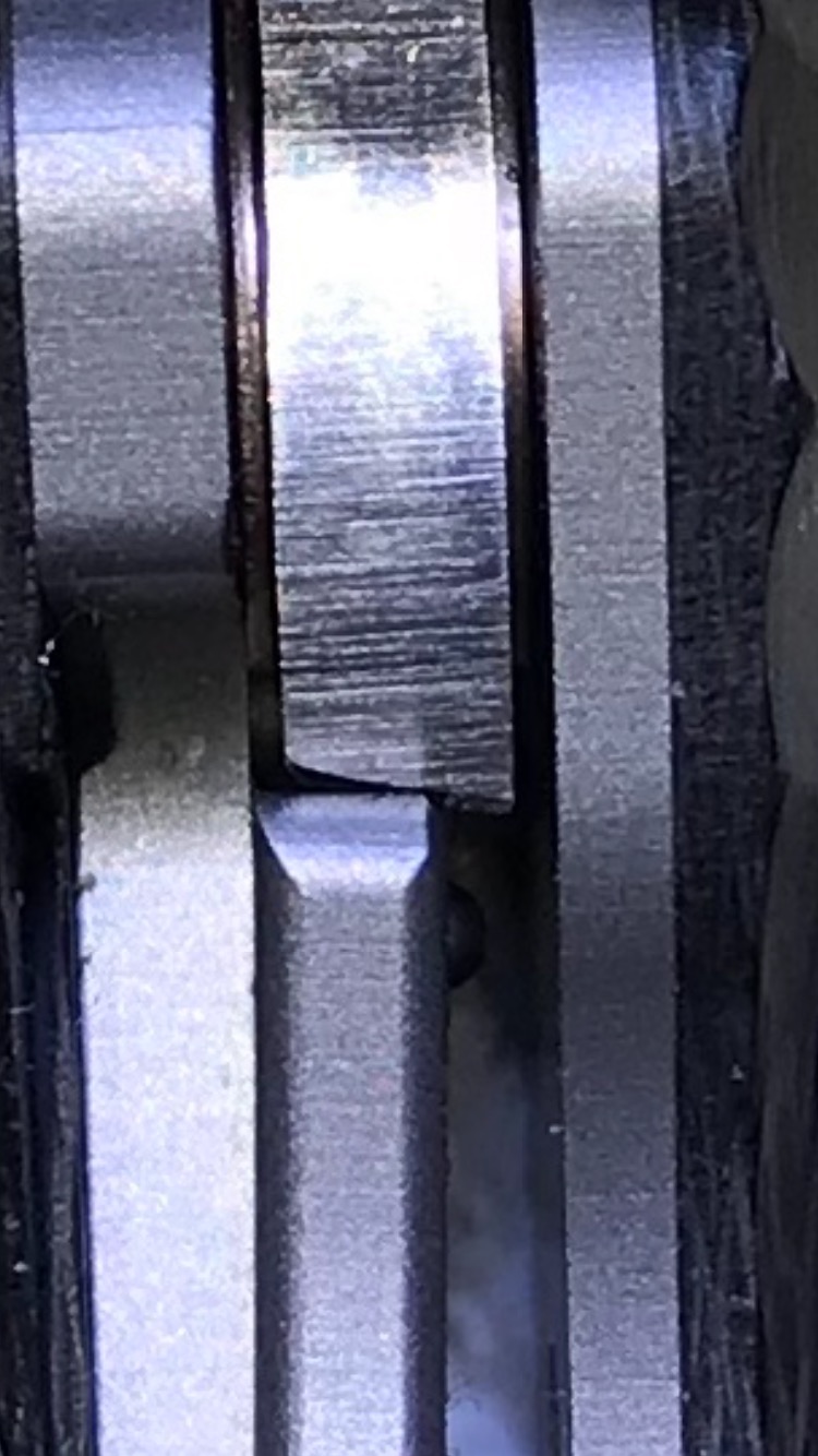

Hello,
Just curious on what your thoughts are on the lockup of my new PPT sprint Carbon. It seems a little late to me. Any thoughts would be appreciated.
PStone
Posts: 2528
Location: Illinois
Re: PPT Sprint Lockup
Post by PStone »
Looks perfect to me. This is mine for comparison.

nelly5 wrote:
Sat Apr 14, 2018 8:19 am
Hello,
Honestly I wouldn't worry about the lockup percentage, I'd be more concerned with the apparent lack of decent contact with the lockface. It seems that the lockface grind is kind of bad to me. Doesn't mean it won't do its job, but I'd be concerned. See how the other example is concave? Yours looks a little convexed. If so then it would mean an incredibly weak lock that would slip any time decent pressure is applied.
And as far as the amount of contact, if done right I'm far more comfortable with a 40-70% lockup than a 10%. I don't know why that became a thing for knives that are meant to be used. For a "hard use" knife that's not actually meant to be used that also has no mission, no real job to perform or warranty to back it up, a la Hinderer, then i get it. Take it out, fiddle with it, then put it back in its box and drawer...you want a lock that LOOKS like it'll last forever without any real reason to think it could. For knives that people ACTUALLY work hard, a good lock that won't fail for years and a solid warranty is what is wanted.

Bodog wrote:
Sat Apr 14, 2018 1:20 pm
Hello,
I think it may be a bit of an optical illusion. The lock face appeared to be pretty level/flat when I look in person, but I can see how it may appear so in the picture. Does that sounds like a better lock up?

nelly5 wrote:
Sun Apr 15, 2018 7:47 pm
I don't know how that convex lock bar could be an optical illusion but if it's ok with you then it's ok with you. It's your knife. I would like to see some more photos before saying anything more but from that one photo it seems very apparent there is a big gap at the edge of the lockbar and it seems curved completely the wrong way. Who knows. Maybe it is an optical illusion. The one from dirtmcgirt seems good.

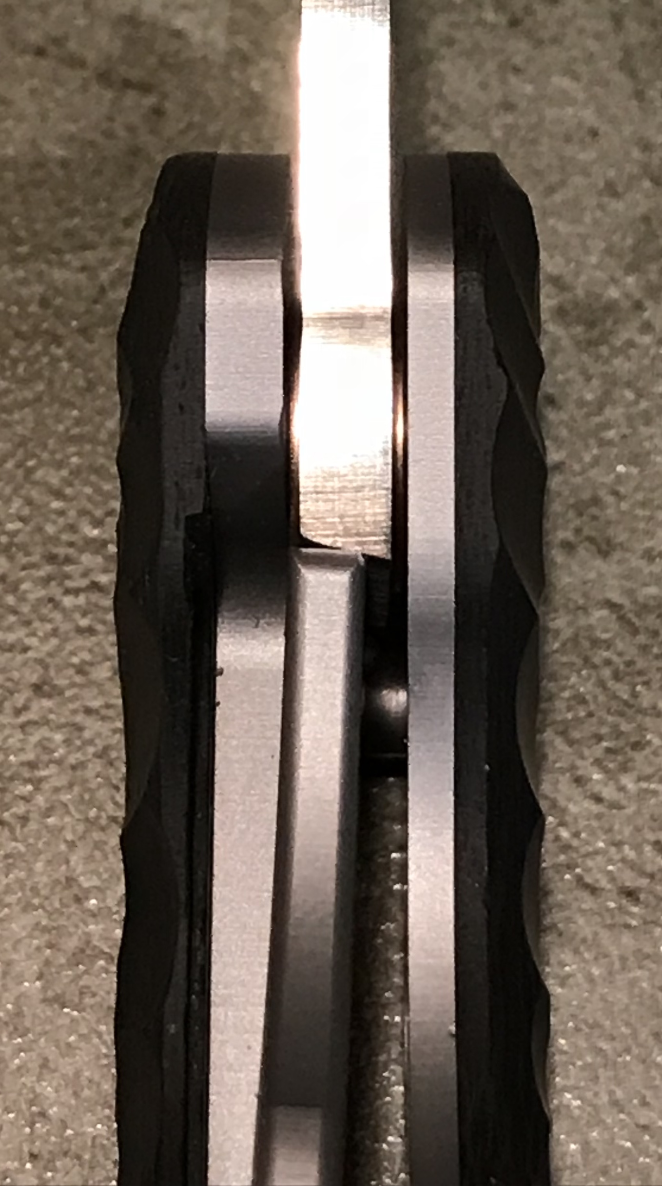

nelly5 wrote:
Sun Apr 15, 2018 9:33 pm
Bodog wrote:
Sun Apr 15, 2018 8:45 pm
Maybe I'm not quite understanding to what you are referring. I don't see convex on the lock bar, as I think it looks flat. I'm by not means a knife expert, and you certainly sound like you know what you're talking about. I took another picture and tried to reduce the amount of shadow and reflection in it. Hope this helps.
The lock face on the tang. The second picture shows the problem as much as the first.

ThePeacent wrote:
Mon Apr 16, 2018 7:38 am
I think he means that the lower portion of the lock (the tang that you press with your thumb) is curved like mountain and not like a valley (from our perspective), so instead of being a hump (convex) it should be a cavity (concave).
Thanks for that explanation. That clears it up. I didn't know a lock face was suppose to have that sort of geometry to it. Do you think this is something I should be contacting the Warranty department over?

nelly5 wrote:
Mon Apr 16, 2018 8:31 am
Two lock faces that look well done. One straight (on the left) and one cupped or concave (on the right) as Bob Terzuola advocates. These are not my knives but show good lock face geometry. Yours looks almost the opposite of the concave version, in other words, aconvexed lock face. Basically the opposite of what you want.

And here is a closeup of yours
See the difference?

Might just be an optical illusion, when I zoom right in I see the front edge has been eased which is normal and the rest of the ramp looks straight, I think it's good to go.
