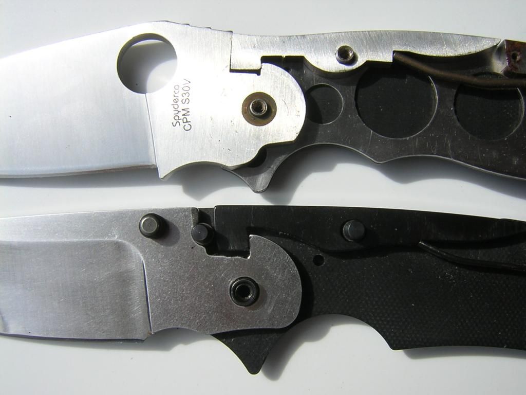

Here is a large(old) Manix and a CS model. See the depth of the lock arm on the CS.
Image[/url]
