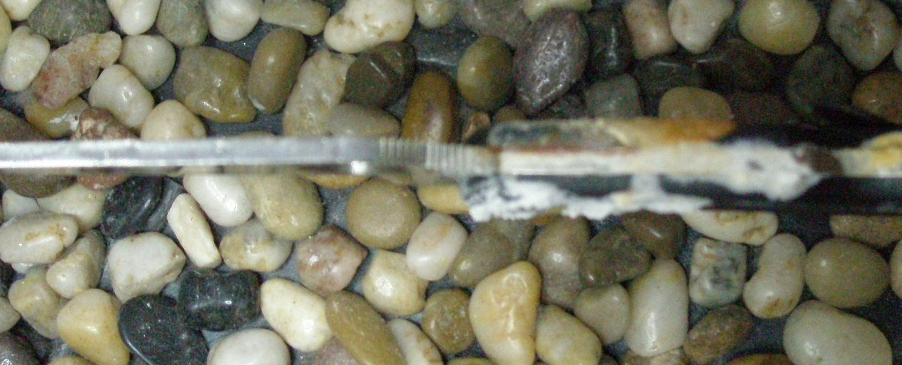

Well, here it is. I took my Black FRN handle SE Pacific Salt and over the past four weeks did a test to see how it stood up to tap water with large amounts of standard table salt mixed into the water. See for yourself: H1 Stainless Steel is technological magic!
The first pictures are the Pacific Salt over the span of the (roughly) four weeks, mostly immersed in the plastic cup of salt water:
Everyone especially take note of the salt deposits on the knife. This really amazed me: The salt crystals must have grown or condensed onto the knife parts by themselves because once I immersed the Salt in there, I left it and didn't do anything to it:

Here are more pictures of the Pacific Salt salt water test:
Now here are the pics of the Salt after I took it out of the saltwater, and, used nothing but warm tap water and a scrub pad to clean it off. Absolutely amazing. Carbon steel and most other stainless steels would likely have been encrusted with rust that would have been alot harder to clean:

Final pics of the Pacific Salt after it was cleaned:
Well there you have it, everyone. Sal and all the people at Spyderco: THANK you for producing the world's best knives and for making a science-fiction dream into real and tangible reality: Humankind's true Rust Proof Steel.

Looks like something corroded in there. Wonder what it was. Any chance of you taking that baby apart and looking inside?
Re: Pacific Salt Salt Water Test: Pic Heavy!
When I took my Dfly to Florida and left it clipped to the draw string of my shorts in the ocean, after getting home I noticed rust around the pivot as well, and found the same rust on my H1 Ladybug. I believe the culprit to be the black washers around the pivot.

I bet you are right. The same bit of rust showed up back by the clip and at was definitely from the washer. I might take mine apart later and have a look. I'll let yall know if I do.Evil D wrote:When I took my Dfly to Florida and left it clipped to the draw string of my shorts in the ocean, after getting home I noticed rust around the pivot as well, and found the same rust on my H1 Ladybug. I believe the culprit to be the black washers around the pivot.

The washer at the clip screws corrodes a bit. A little cleaning and they are fine though, no pitting, just a little surface rust, they come clean when treated with cleaning agents containing abrasive particles (I guess barkeeper's friend is something like that).
