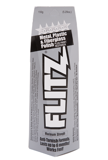

I would not recommend anything super abrasive or harsh. Start with a mild cleaner and a soft cloth. If that doesn't work (like you said it didn't for you), perhaps a product like (Loctite) Naval Jelly or Flitz polish and a soft cloth. I would advise caution as either of these could possibly remove the etch that brings out the differences in the layers of steel. Start small and using thin coats, while not letting them dry on the blade. Good luck.

Transversely, you can use Flitz combined with a scotch-brite pad for a super aggressive surface cleaner.

I would highly recommend Fitz. If you make sure to clean it well and oil it afterwards loading a wash cloth with tooth paste and stropping the blade might work as well. As with any abrasive be sure to check your progress after a few strokes.
The more you spread out the abrasive the more homogeneous the results will be (ie: not one shiny spot here and there). The less aggressive the abrasive and rate that you apply it the slower it will cut. This is the slow way to do it but with such a nice knife I would prefer to spend more time prior to ramping up the intensity...plug in a movie while you work. :)
