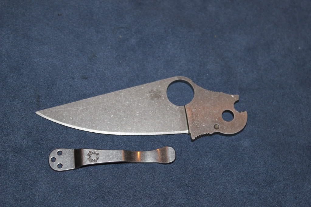

I would suggest ordering a black clip specifically for a Vallottin Sub-Hilt. The coating on them is different than other black ones I've seen, and it has a laser etched spyder...it's very nice and seems to hold up to scratches better than most. If you don't wanna order a new one, you can always acid etch and/or stonewash your current clip to get rid of the shine. As for actually painting them, I wouldn't waste your time, as nothing I've tried holds up. I've even tried 1200 degree header paint baked on and it scratches off easier than the factory coating.
Sub-Hilt
My acid etched clip with natural wear stonewashing

Very easy. You can either put the clip in a plastic container (like a peanut butter jar) with a bunch or random rocks and shake the crap out of it until you reach your desired finish, or you can acid etch it first to completely get rid of the shine. To do this you need to hit up Radio Shack for some ferric chloride and soak the clip in it for 1/2 hour or so. From there you can leave it as is (a very mat gray color) or continue on to stonewash it in the peanut butter jar. I left mine gray and let wear do the stonewash. All said and done, a new clip will probably be cheaper than the ferric chloride, but the factory black is also going to eventually start scratching off.
