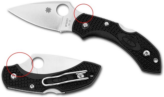

But using the dragonfly as reference, it does not have this flaw and looks sleek even at the closed position. the dragonfly's blade and handle are like one piece, sleek and smooth in the open and closed position.
[ATTACH]20312[/ATTACH]
In my opinion, furture spyderco lockback design should be sleeck and smooth in design like the dragonfly to further improve the delica in the aesthetic department. Same goes for other knives with this gap.

What you're missing is that it's BECAUSE the Dfly has the 50/50 choil, that it doesn't have that gap like the Delica has. It's a product of the half of the choil of the handle matching up with the curve of the thumb ramp. Since the handle of the Delica at the tang isn't shaped to flow into a 50/50, it stops abruptly and leaves that gap. The only way you can counter this without the choil is to fatten up the bottom of the handle so much that it covers the gap, but then the grip is gonna be really funky because it'll be real thick at the tang and your index finger will be pushed further away from the cutting edge.
A Kershaw ZT is a good example of this. They put the choil all the way back into the handle, which makes it protrude down far enough to cover the gap, but look how far back your index finger is as a result. Personally, i'll stick with the gap before i push my grip that far back away from the blade.
The only other way i can think of to get rid of that gap would be to extend that portion of the tang way back (forward when closed) and then in turn shorten the lock bar so that the lock up action is further down towards the butt of the handle. The problem with that though is that you have to move the pivot somehow to correspond, so i'm not sure if that's even possible. In the end it's really just a result of the handle design more than anything, and really the only good way i can think of to get rid of it is with a 50/50 unless you radically change the grip design, which then just wouldn't be a Delica.
