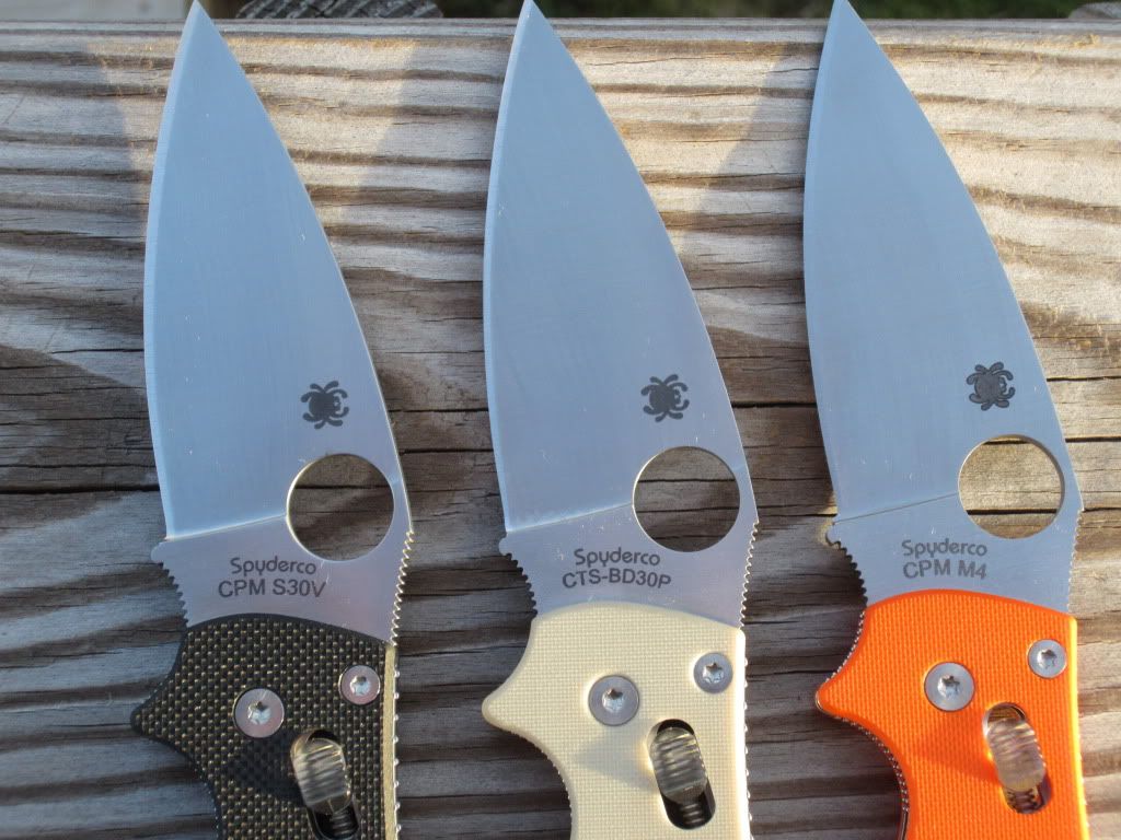

Post by 46Alpha »
Scale swapping is good for the soul :)
