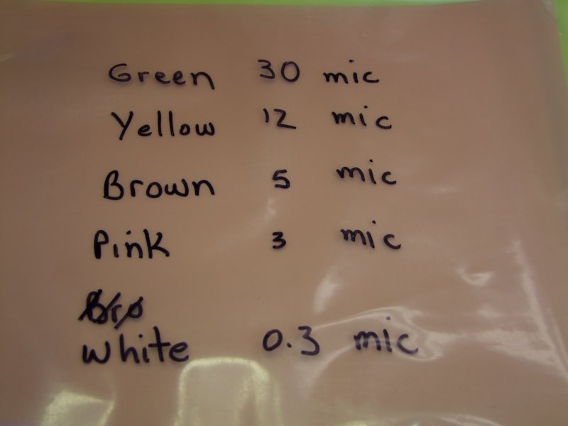

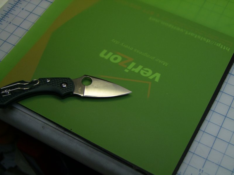

I profile/re-profile using a Lansky Diamond sharpener or Sharpmaker, and then create a slight convex edge by using 3M Lapping film against a soft back using 3-4 steps until about 5 or 3 microns.
If I am just touching up, I go straight to the 3M Lapping film.

Where do you get the lapping film?
