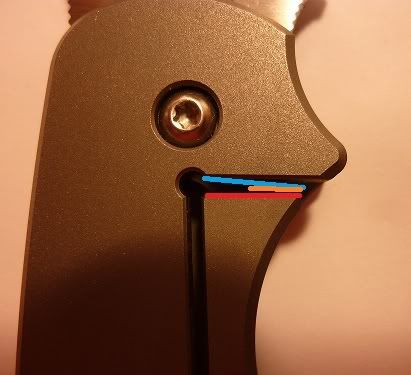

Ok, since the picture I took doesn't actually show the lock engagement, I modified it in paint to show (with much exaggeration) what I'm talking about. If the red line is in line with the lock bar surface, then the lock surface of the tang is the blue line.

If your "exaggerated" lines represented my Sage2, I'd want to send it to Golden for some kind of correction. How exaggerated are your lines?Muad'Dib wrote:
I understood what you were saying and the picture verifies it. I will have to pull mine out but it seems like I remember reading that frame locks many times are designed like yours. I think it was the Sebenza that is an example of that but I don't have one of those to know for sure. I know on many framelocks, the lock only engages a small section of the tang, which yours is effectively doing by being angled.

My "diagram" is definitely exaggerated. I've added an orange line to indicate approximately how much contact there is in that dimension (based off of the markings the Ti leaves on the tang lock surface). As far as the lock engagement in the normal direction, that seems more than adequate (approx. 2/5 of the tang). Thanks.

I think that's what I'll do (unless someone tells me that it is definitely abnormal and problematic). I just have a tendency to obsess about new toys. I also worked as a quality engineer, and have a tendency to look for problems.FlaMtnBkr wrote:I think if it locks up tight then use it and enjoy it. If it starts to get some play or another problem then know it has a good warranty and should be taken care of if there is a legitimate problem.
