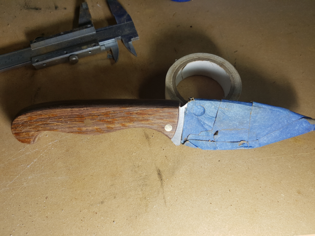

So, this project sat on the shelf for a long, long time. First I determined that I really didn't have the workshop or tools to modify the hardened steel in the required fashion. Then a few years back that changed when I acquired a house and put a little workshop into the basement. At that point I chopped up one of my M390 mules.
I also bought a small chunk of cocobolo, but it wasn't thick enough to do book-matched scales, and I just never got around to finding anything else. Finally last week I said screw it, this isn't supposed to be a presentation piece just a utility knife in my kitchen, so....
Now I've got the scales epoxied on and almost completely shaped. Just have to do the finish sanding.

Looks like you're gonna have a great kitchen knife. Really liking the whole concept. While there have been many beautiful scales made for the Mules by different forum members, your design and workmanship add a new dimension. Looking forward to seeing the finished product. Sal must get real pleasure out of seeing so many Spydie fans create such works of art.
