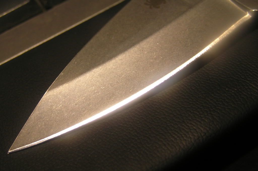

Posts: 28534
See i can't really help you there, especially if you're gonna use the Sharpmaker for touch ups...someone who has both will have to guide you on that, since if you use the wrong setting it may make it harder to use the Sharpmaker...ya know?
I almost made a thread about the Manix bevel when i had mine but i didn't feel it was bad enough to bother, and it was easy enough to fix so i let it go but i did get this pic of it.
It was higher at the heel than the tip. It didn't really effect sharpness, i'm just a perfectionist so i made it even. Oh and the edge isn't chipped up like it looks, that's just reflection on the edge making it look all ragged.
As far as doing the bevel, yeah you just go at it. I'd recommend always using a marker on the bevel if you don't already, it helps to see where you're hitting and what you're doing. I do one side all the way until i've made a burr on the edge, that way i know i've got that side completely down, then i switch sides. It can take some time but 154CM is among the easier steels to reprofile.
